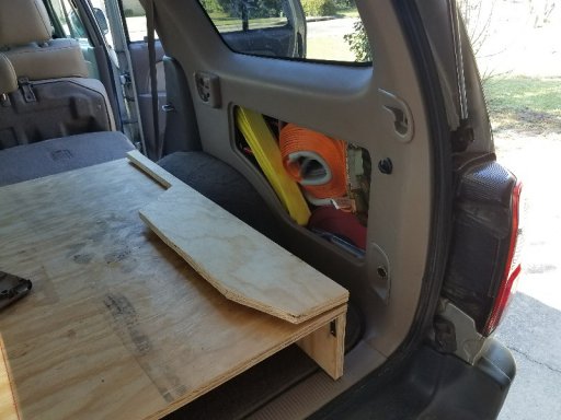

Added a pic of the foldout wing of the sheeping platform, which allows me to lay down the compressor to get to the (enlarged) side storage compartment. Between this, the two little side cubbies, and one of the drawers, I was able to stash away all of my recovery gear (including jumping and tie-down accessoried), and still have a whole second drawer free for camping gear!

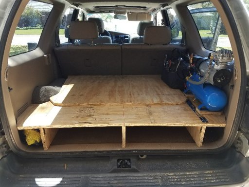

Sure! I will grab some mor soon, but here is what I have from when I started the platform last year. The front / top swings on a big piano hinge (available at home depot and lowes) that I trimmed to my required length. When folddd forward, the front end rests on the top of the folded-down back seats to give enough room to close the hatch without bending my legs.
I made it this low because I measured the height of the top of my largest dog's head, added 2 inches, and made the box short enough to allow this.
