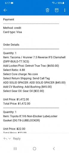

So I took the plunge... decided to regear my 4runner to 4.88 and add Detroit Truetrac in front and Yukon grizzly locker in the back. The 15th my 4runner will be sitting on jack stands for 2-3 weeks.

How did the regear job go? How are you liking driving with that rear locker, and the true trac? Who did you order parts from?
I went through East Coast Gear Supply, I pulled my differentials out and sent over to them to set up the differentials. The removal of the rear diff was a breeze, the front was a bit more involved especially having to wrestle the diff out by my self. Driving with the locker dose take some getting used to but its not bad. As for the truetrac I have used it on my dirt driveway, the steering it noticeably heavier.
