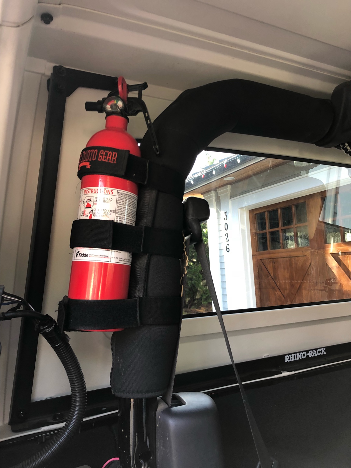

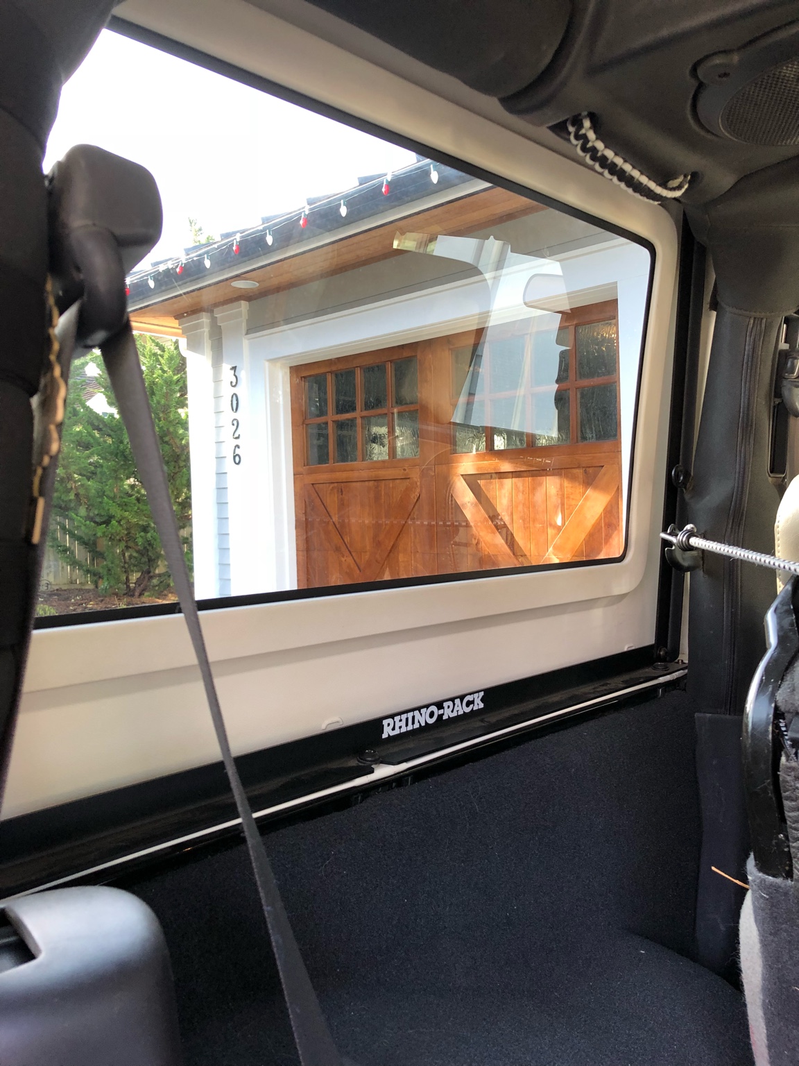

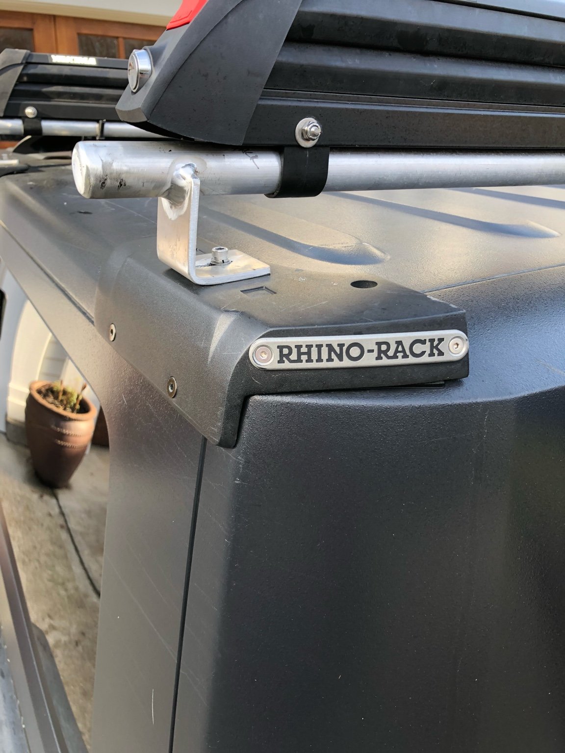

Awesome rig! Can you tell me a little more about the roof rack? Is it attached solely onto the wrangler's hardtop? So if you take the hardtop off, the roof rack (still attached) comes off with it? I'm looking for something exactly like that. Are you happy with it?

Thanks! Sorry on the slow response I haven’t checked this forum in a little while. The rack has internal supports that mount to the tub like the hardtop, then a landing pad mounts through on the outside. The rack is attached with 4 bolts, it usually takes me about 10 mins to bolt/unbolt the rack. Because of this, you can remove the platform from the top so it’s essentially a Jeep without any rack on it, I take it off when not in use because the tent hurts fuel economy. There’s also an option for quick release mounts but it was a bit more expensive so I went with this option.
And I absolutely love the rack, rhino rack makes a lot of accessories for the platform so you can mount just about anything to it, I resorted to making some of my own accessories to fit my needs for a bit less than they charge. The other thing I love about this set up is that I was able to have some cross bars made that mount up to the landing pads for my ski rack in winter!
I snapped a few pics of the supports and such, I hardly notice them unless someone in the back seat points them out. But overall it’s a very sturdy rack.
