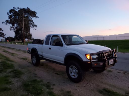

Warn winch will go on after I figure out my supporting mods such as the big 3 and battery.

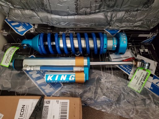

This truck wouldn't be fun if it didn't have a lift so when the opportunity for a group buy popped up, I took a chance on it!
Purchased Fox 2.5 coil over fronts and Fox 2.0 rears. For the remainder of the rear, I went with OME Dakar leaf springs, Wheeler's Super Bump stops, u bolt kit, and other odds and ends.
And just like that, I'm already going to replace my Fox 2.5
In a half drunk stupor, I was back and forth between getting my Fox shocks converted to extended travel (by means of replacing a bushing) but instead I bought a new set of King 2.5 coilovers.
