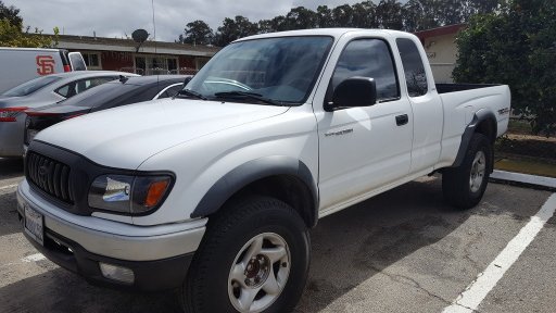

2001 Toyota Tacoma Prerunner Access Cab
First picture, all stock with street tires
Now as of 2020
First order of business, aside from maintenance, is to replace those fogged up lights and side markers as well as deleting the chrome.

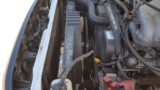

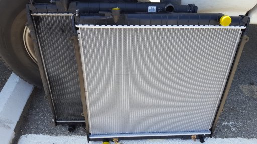

Since the truck is pretty new to me, and my intentions are to use this rig specifically for camping, I went on to address any and all much needed maintenance.
Here's replacing the radiator and coolant, since the current radiator had a hairline crack. Didn't have any overheating issues at all but I don't like to leave things to chance.

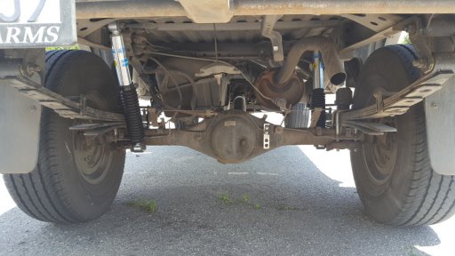

Over the next 2 months, I racked up a few thousand miles to allow the rear to settle, but since I don't carry much weight I wasn't happy with the Fox 2.0's.
I opted to try out some Bilstein 5100's -

So yes, Fox 2.0 are an upgrade from Bilstein 5100's but I didn't purchase the OE replacement that Fox lists on their site.
Since I wanted more rear travel, I opted for the "universal" rear shock for the full 8.1" of shock travel. Only problem with that is, the valving is different even though 1 source initially claimed that the valving was similar to the OE replacement for my truck.
When I first installed the Fox 2.0's, I thought it was weird that I couldn't compress the rear shock without putting all my weight into it. Installing the Fox rear's consisted of me jacking up on side of the truck and flexing the leaf springs just to get the shock mounts to match the shock. Test driving the truck with no weight in the rear (before I got my rack and bumper) really sucked; going over speed bumps would make the whole truck "jolt" and well..you get the idea.
I reached out to Fox and later confirmed from someone else that works there, that the valving is indeed different from their OE replacement even though I was told they were the same. A revalve will cost me $35/shock and shipping on me. So right now, at only 150 miles give or take a few, they're paperweights until I figure how much weight I'll carry in my truck.
I ordered the Bilsteins since they're cheap, and I figured if I don't like them, I can just give them away. Well, it was night and day and I actually enjoy driving off-road or on really crappy roads. Since I just installed my Tepui yesterday, I've been even more impressed with how the truck feels. Even going over a speed bump quickly is fun!
I've read that if you want a better off-road feel, go with a digressive setup. Progressive will work well off-road as well (versus stock) but they feel a lot better on-road as well.

And since I have more weight in the rear than I did before, I went ahead and cleaned the underside of my truck, and reinstalled the Fox shocks.
