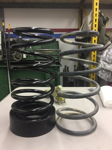

4 crawler offroad 1.5" BJ spacer/rear coil spacer, sway bar drop, rear proportioning valve spacer, 1" diff drop

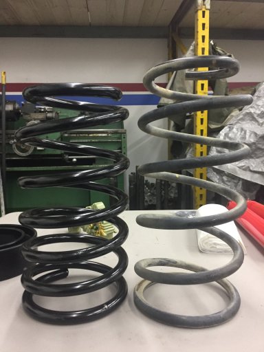

Moog stock size rear coils
KYB red +2 F shocks
KYB red R shocks

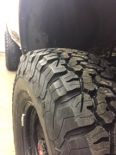

BFG 33x10.5x15 on steelies

The torsion bars were fully cranked as it sat, so I completely relaxed them. I wanted a comfortable highway ride, and with them maxed out you couldn't even flex the front suspension, not sure how the PO drove it at all.

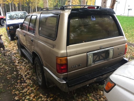

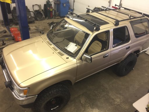

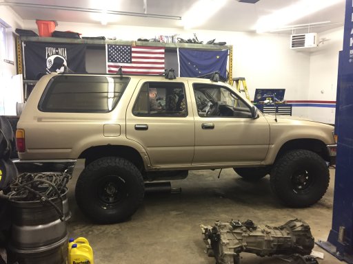

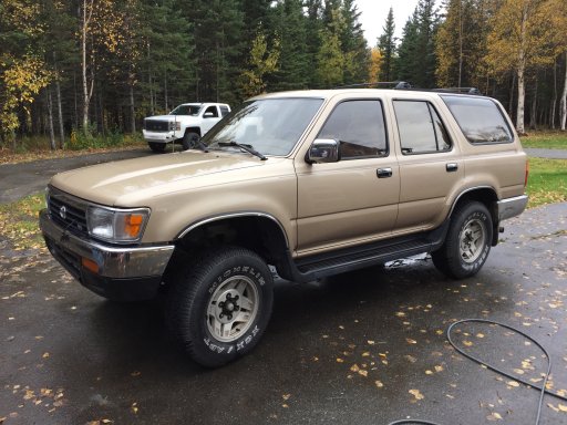

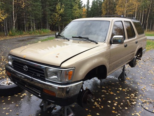

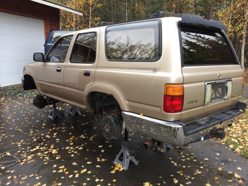

This is how it looked when we made the deal:
It came with little history besides a local school teacher owning it for some time. Besides the years of crud that had accumulated it was in remarkable shape.

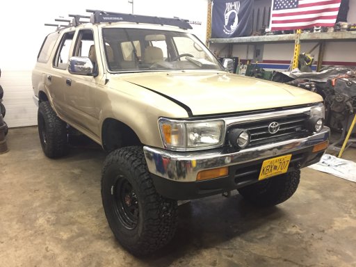

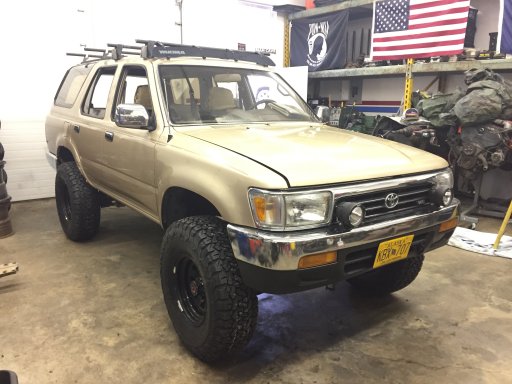

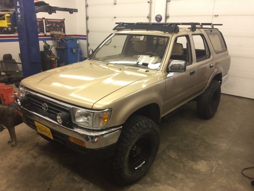

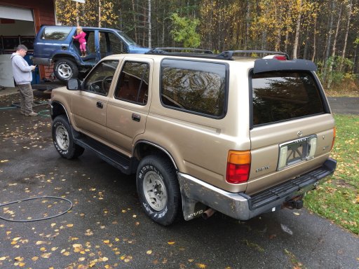

After it was cleaned up initially:
Pulled off the stupid side steps and chrome trim:
