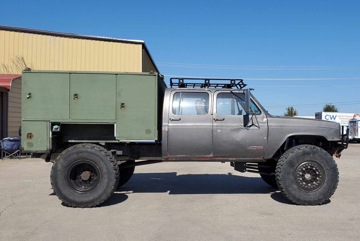

I don't get downtown very often, I am more worried about drive throughs! Honestly though, it looks really tall but it is about 8' 3" tall for now. I will have to double check the height after I do the shackle flip.

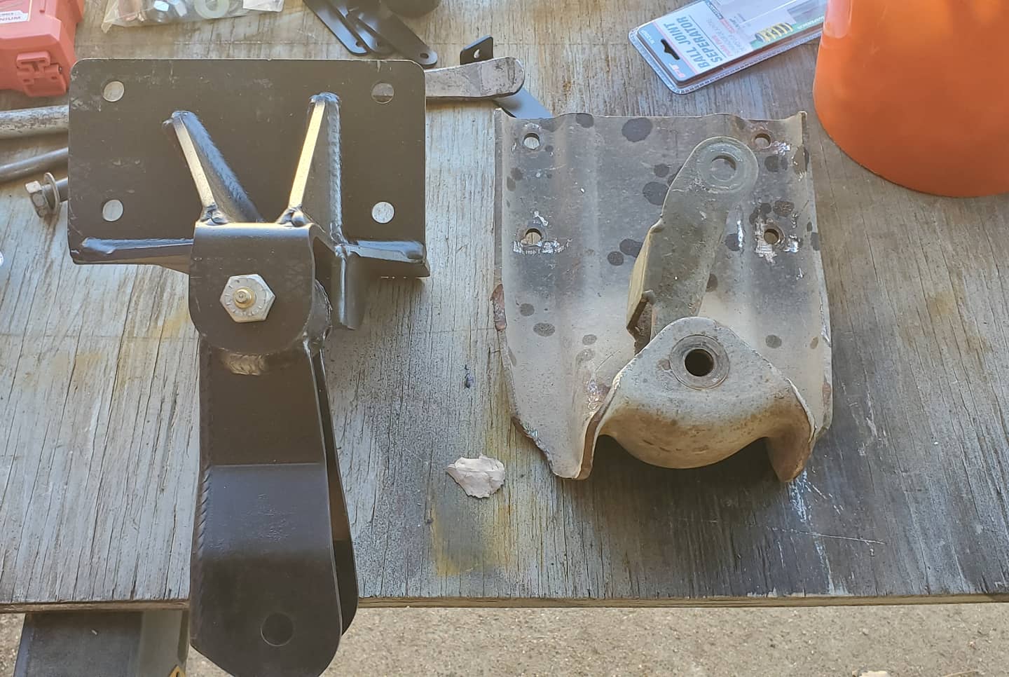

Short post today, got the shackle flip install and was reminded why I hate frame rivets.... I installed the flip without dropping the tank, care had to be taken to not send the chisel through the side of the fuel tank. After some very choice words and a sore shoulder from swinging a hammer it was all removed. Got the holes drilled out and the new shackle flips bolted up, I am extremely happy with how it sits, I think it could stand another inch in the back but I am not worried about it. At some point I may put some helper air bags on it but I want to drive it some first to see if the coils settle any. Last few things before some shake down driving is a new pitman arm, building/adjusting the rear shock mounts, and clocking down the transfer case. There are some other little things like axle breathers and aux lights but those are not major.

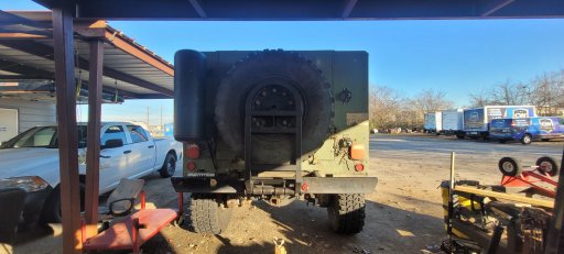

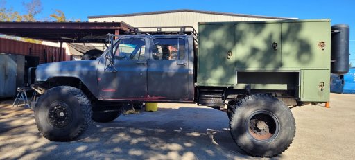

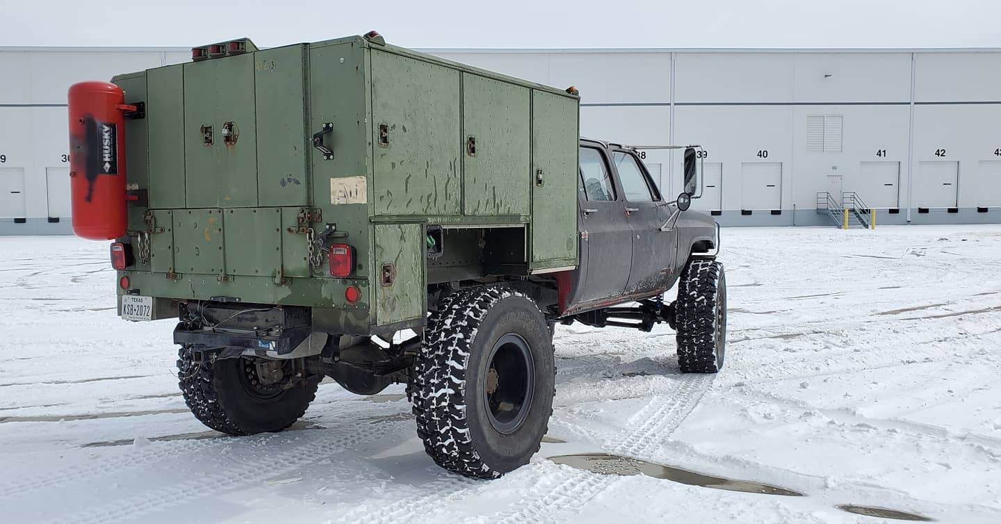

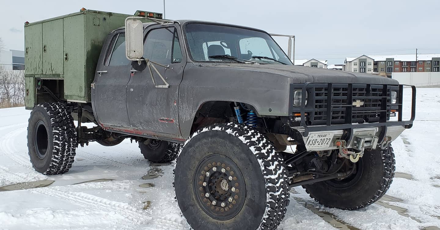

I'm sure most of you saw that Texas had some craze winter weather two weeks ago. My family and I were fortunate enough to maintain power through the storm. I saw the slick roads as a good opportunity to road test the truck. With the hubs locked in and the case in 4hi it handled real good. I have been slowly stretching out how far I drive it but so far everything has been pretty good. Here are some photos from the "snow run"!
