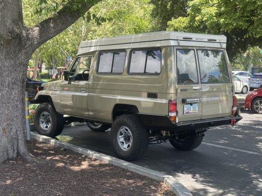

Big day today. AluCab mounted. Since the body never had the roof installed (and cut) and was deformed, we spent 2 hours trying to fit it, grinding a bit the bottom, and slightly bending to widen the roof. It was stress initially but at the end I'm satisfied. Could not have done it with out help of friends and family. We used the winch of the 40 for the heavy lifting.

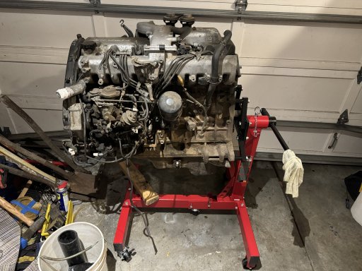

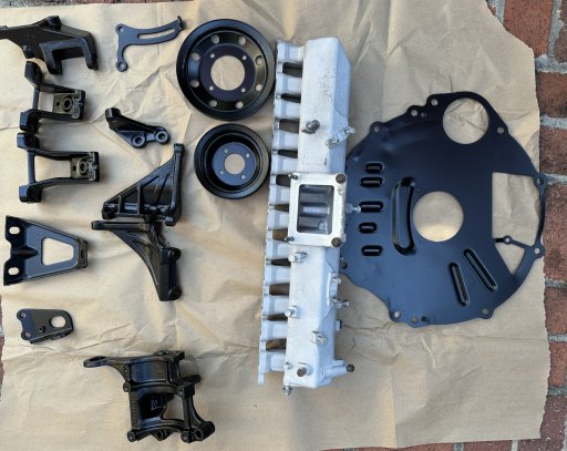

Got the engine that I really wanted. The 1HDFT 24 Valve direct injection Toyota. I'll baseline it, and swap after driving the rig for 500 miles. Probably sell the 1HDT that is installed currently.

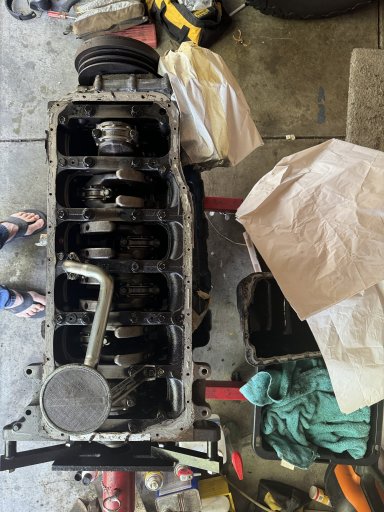

While injectors and IP are being rebuilt, I’m prepping the engine for Bottom End Bearings replacement. It’s so much easier when engine is on the bench avoiding a black oil shower.

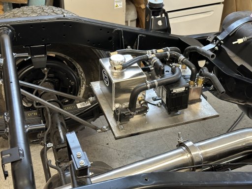

Today I got from my friend Marti the welder the 32 gallon water tank that will sit under the car instead of the spare. There is a loop of 1/2" stainless pipe to allow 190F hot coolant from the diesel hearer in freezing weather to protect the tank. The hot water has a water-to-water heat exchanger and the cab a water-to-air.IMG_0751.JPGIMG_4019.JPGIMG_4020.JPGair heat

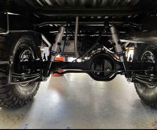

Finally got the shocks. Tried to get a set of Icon shocks, but they were horrible in customer service. Never returned my calls with information and finally gave up. I'll need to fabricate a custom bracket for the bottom front.

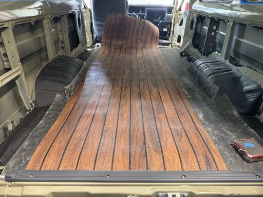

Been working on sound insulation. A friend recommended this material to the sides of the rig. It’s expensive so hope it works. Very easy to install.

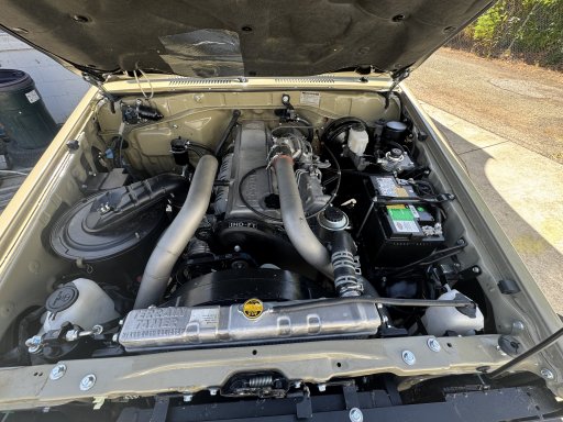

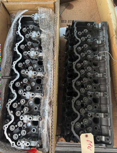

It was a test for patience getting this engine together. I decided to take the head off and discovered 2 minor cracks typical to diesel.
I ended up ordering a new head (of a 1HDFTE) and need to modify it a bit. Meanwhile I found a place that can bring the used engine to spec.
Yesterday was a big day and it...
Finally Started! <<<<< The sound was music to my ears.
This should get into the engine bay of the troopy before end of February.
