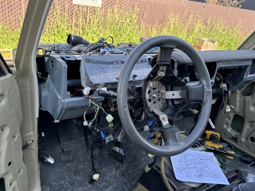

Started working on electrical and dash. Pedals from 80 series are in. Needed a bit of mods. It’s all good (I think…)
got support from iH8mud on the puzzle of routing the harness and all the brackets. I was so excited about taking all apart that did not take enough photos. Also the wire loom is from a Euro model because the original was toast.

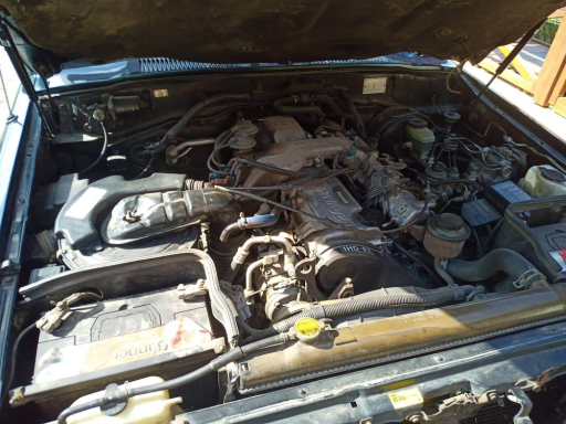

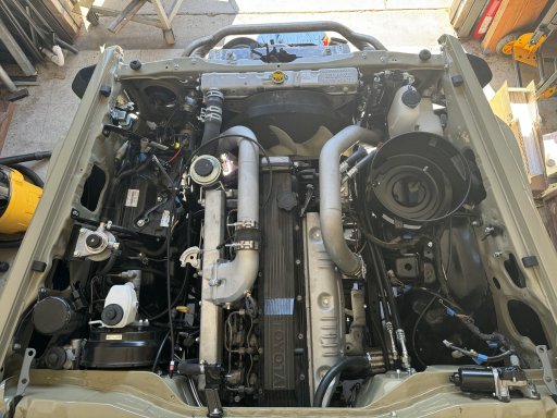

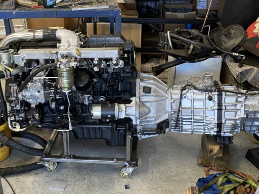

So some bad new and some good news. I am pulling the drivetrain out and swapping the engine.
I just came across a 1HDFT that a good friend sold me. Less than 100k miles. Could not resist. Would be nice to have both 80 and the troopy with the same engine. I know it's a bit insane, but none of us is really normal people...
First photo is the 1HDT that is coming out.

Hey Sam,
The 1HDFT (FT) engine is the last mechanical engine Toyota built. It’s from the 1Hx family. 4.2 liter 6 cyl. It’s a direct injection 24 valves. It runs cooler and smoother and has more power then the 1HZ (no turbo) and 1HDT. The next one in the family is the 1HDFTE that has electronic control.

Hey Sam,
The 1HDFT (FT) engine is the last mechanical engine Toyota built. It’s from the 1Hx family. 4.2 liter 6 cyl. It’s a direct injection 24 valves. It runs cooler and smoother then the 1HZ (no turbo) and 1HDT.
Nice. So more grunt, mechanical FI, better cooling, no precups to drop. Sounds like a solid deal to me. Thanks for clearing that up. I haven't spent much time around the non IDI engines.

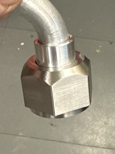

I can’t find the two hoses that come out of the evaporator in the firewall. We are machining the nuts and tubes that fit there and TIG weld it to crimp fittings.

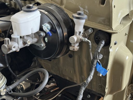

today I finished making and installing the fire wall brake lines. Loaded brake oil and bled the lines. 2 minor leaks. They are fixed and I think at this point I can stop.

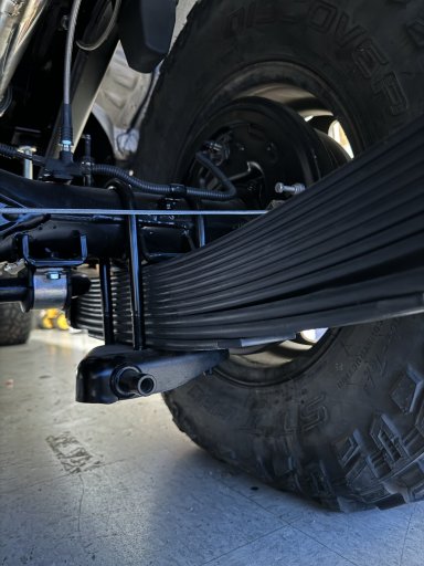

Trying to source some electrical harnesses for the AC, as well as some fittings. A friend machined the nuts for the evaporator fitting in the firewall. Also replaced the U bolts and brackets on the rear springs that give 1" of clearance and protects the U bolts. Two photos compare the OEM vs the new one.

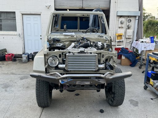

Struggled for two days to line up te front fender. Had to use spacers. Apparently the rig that come from South America are warped. ‍Seems like finally the troopy is smiling.

AC lines are done. All electrical for the AC is done with OEM parts (except the AC switch).
Intercooler had to be chopped again on top so the hood will not touch it. $40 TIG welding, and no guts no glory on the table saw... I really messed up on this one.

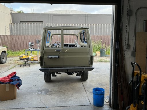

Electrical slowly integrated. Lights, starter, wipers etc all working. Installed the BMW M5 manual heated seats and got the AluCab popup roof to the shop. Will install in the next few days including all the glass.
