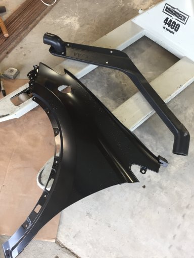

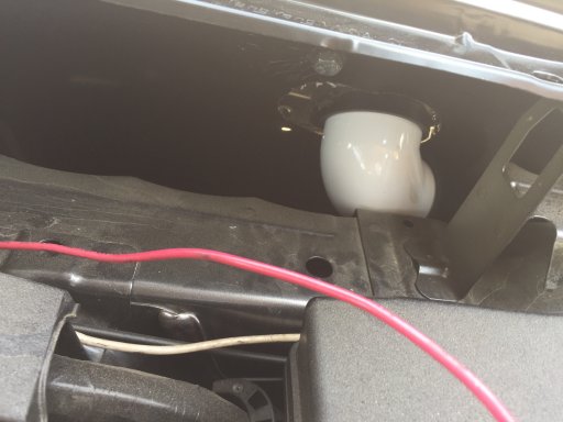

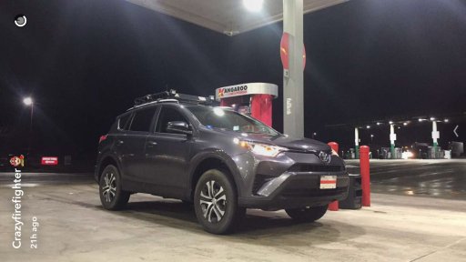

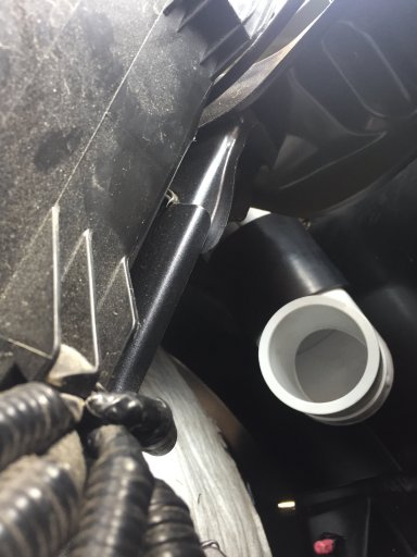

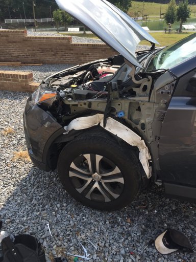

IMG_2953.JPG IMG_2981.JPG IMG_2984.JPG IMG_1865.JPG IMG_1864.JPG IMG_2953.JPG This is my 2016 RAV4 LE AWD that I am rigging up with stuff. The roof basket I bought from Walmart $100. The LED POD lights on the roof basket are off of amazon $16.99 for the pair. After drilling holes in the baskets lower frame I installed them and wired them up. The two on the front are spot lights and the two on the sides are fog lights. The snorkel is a tough challenge I have accepted. The snorkel was for a 90's jeep Cherokee that I bought from a guy for $70. After seeing how the lower part of the snorkel would fit the fender well enough to work. I bought another front driver side quarter panel off of Ebay for $65. The snorkel was cut in half where it starts to go up the A pillar. After putting a 2" rubber hoes I bought from lowes for $4.38 between the two holes. I twisted and bent the top of the snorkel to the right angle so it was parallel to the A pillar. After that I molded it where I had cut it in half and painted back of over it. After seeing how the paint looked off from the rest of the snorkel color. I then thought it was best to wrap it. So I picked gorilla black tape for now. I drilled holes in the new fender and mounted the snorkel as you can see in the pictures. I had to cut the piece where the snorkel goes into the fender because it would no clear the top framing of the car. I am now working on hooking up the snorkel to the air box and sealing off everything.

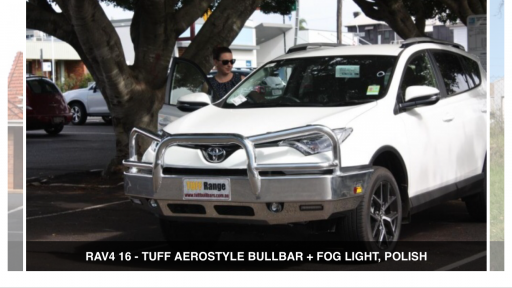

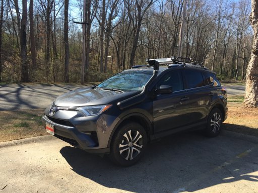

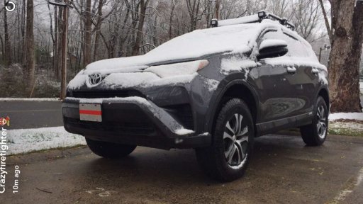

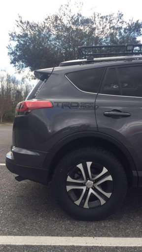

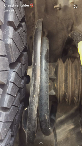

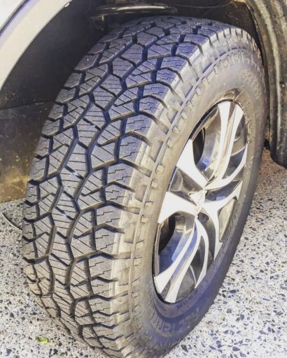

IMG_3325.jpg IMG_3312.JPG IMG_3316.PNG IMG_3310.JPG IMG_3297.jpg IMG_3342.PNG IMG_3325.jpg Thank you guys. Sorry I havnt done any updates. I put a lift kit on it march 1st and 2 weeks later 245/70/r17 pathfinder all terrain tires. The snorkel was removed and working on making it more clean looking and having an actual hook up to the air box. I will be at the yotamafia meet in Alanta Georgia and I will also be at the overland east expo later this year camping out. Here are more pictures of the lift and tires. I also attached a picture of a RAV4 with a bumper I'm thinking about getting
