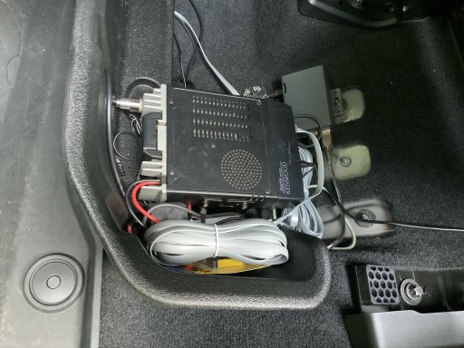

Radio under driver's side rear seat - it works but I need to clean it up. So many other things to do and did I mention it works? Hahaha
Faceplate on RAM Tough-Track - purchased extension cables for radio's faceplate and mic. Faceplate cable has since been buried in the trim.

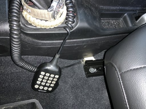

Mic popping out from under driver's seat. This is where I like my mic as I keep it in my lap; easy/quick to find on the trail and can be clenched between legs when the going gets rough.

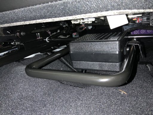

Cheap speaker under driver's seat using hacked up mounting bracket. Big black U shaped bar is seat forward/back adjuster. More than loud enough for my old damaged ears.
Original speaker bracket
Hack job speaker bracket
