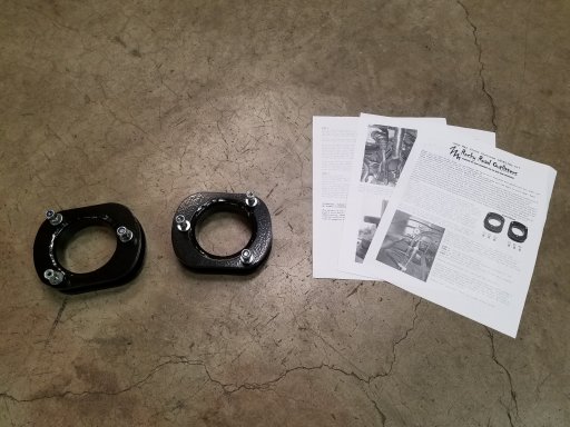

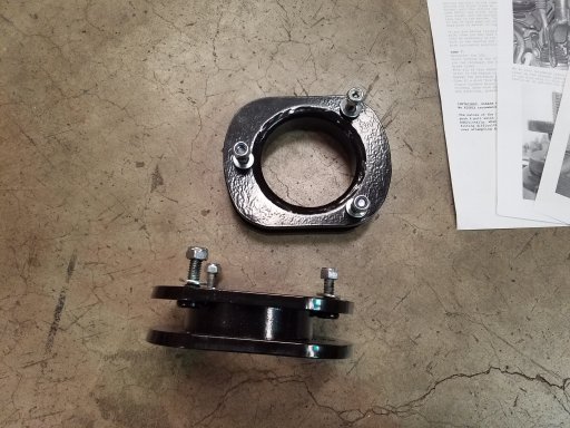

Here are pictures of what you get in the kit.

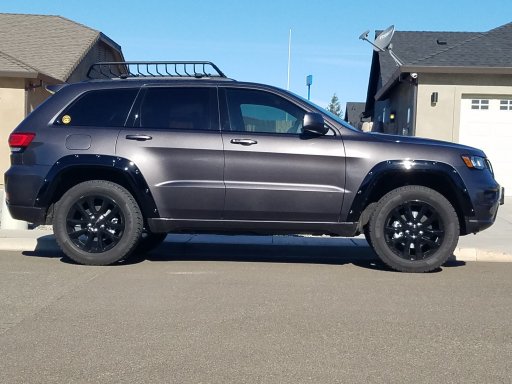

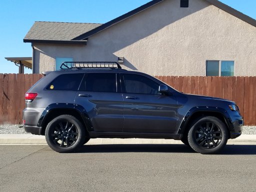

Here is the before and after stance of the vehicle.
Before:
After:

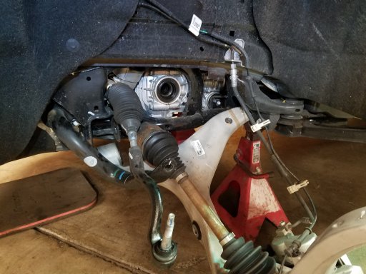

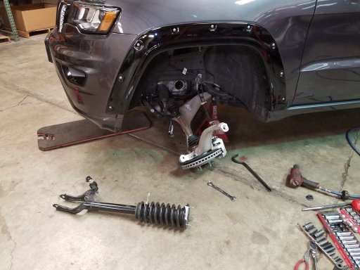

And photos in progress:
The drivers side is the hard side. You will have to remove drive axel to remove the strut. The passenger side was much easier. With 2 people you should have no problem with removal and install.

You will love it when it gets there. It really is straight forward, the only thing I would say is that in the directions it says "you may need to remove the drive axle" when it should say "you WILL have to remove the drive axle" (drivers side only). There is no way I could have gotten the strut out without removing it, the lower control arm doesn't even come close to falling down far enough for the strut to clear it and come out. The drive axle comes right out though and went right back in with no problems. You will definitely need two people to do it, just to many things to hold, push, pull, screw, etc all at once to do it on your own. The passenger side is a breeze. Takes half the time as the drivers side and you will need a front end alignment for sure when your done. Well worth the time and money! If you have any other questions, don't hesitate to ask.

Nope, you won't need to mess with the coil spring at all other than just to pull the entire strut assembly out and mount the spacer to the top of it. Once you do remove it, take the 3 nuts that were holding the top in place and screw them back on to the posts and tighten them all the way down so that when you cut the post you can unscrew the nuts to clean the treads. Don't use the nuts that come with the kit for that part because they are the type with the plastic locking insert and you only want to use them once. If you look in the last picture, the tool that is laying on the ground with the hook on one end is the tool we used to pop out the drive axle. It is just a hook shaped flat pry bar.
