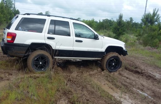

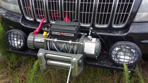

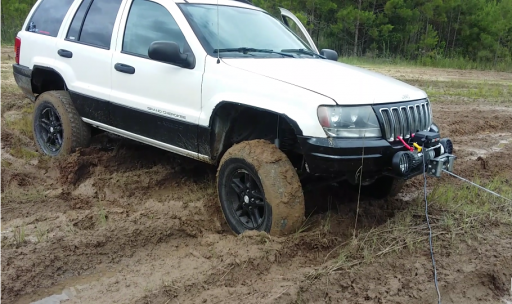

Got to test the Winch out today.
It finally stopped raining, so I hit a few trails near the house, not many pics, not a lot to see there. On the way out I mistakenly cut across the muddy ruts and had to put the winch to use. Screenshot_2016-05-31-16-22-48-2.png
Normally I wouldn't have cut across them but with the new locker I was doing really good, plenty of traction until then. The nearly bald AT/Radials didn't help.
Not gonna lie, I wasn't to upset I had been itching to try this thing out anyway.
Winch worked good, other than a short duty cycle (30-45secs), and slower line reel rate compared to others i've seen used.

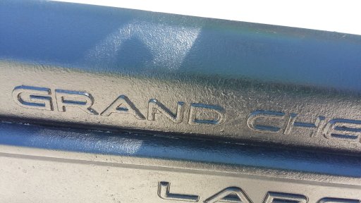

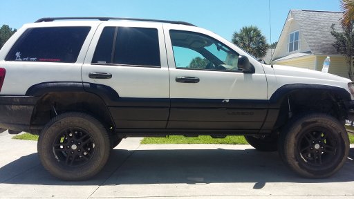

Bedliner: The cladding, fenders, and Bumpers.
Started Bed lining the Jeeps lower half today, the project will cover the cladding, cut fenders and bumpers.
Sanded everything with Auto grade 180 grit sandpaper (bedliner instructions recommend 120-220). washed and wiped it down, then tapped it off.
I bought "frog tape" I had heard good things, unfortunately I was very disappointed. One thing it doesn't bend/curve around corners like 3m auto tape does, this left me with very straight edges and corners, plus it bled through in some areas, even though it's specifically not supposed to.
Bed liner was 1 gal of Rustoleum Bed liner "professional".
First layer was a little interesting, didn't have much texture, and refused to stick in a few areas. Honestly had me a little worried.
After a couple touch ups with a brush and a few hour wait, I rolled on a second heavy layer. I learned that if I waited for it to get tacky and rolled brush over it i got more texture like I wanted.
As you can see the lines are far from curvy, so i'll re tape with some 3m and get a smoother look, tomorrow.
Also the Frog tape left tape goop, not very good quality despite the price. :(
Goof off will get that too.
The questionable line on drivers door was where it bled through and i tried to touch it up. Gotta fix that tomorrow as well.

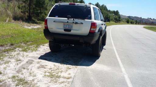

Sanded and Scuffed up the Bumpers, the front was actually from a color match limited black, and had a gloss finish so took a little more than the rear.20160609_102419.jpg
Same process as before, rolled, touched up, then rolled heavy to get texture.
Need to hide those power cables for winch better, and still haven't gotten the front skid put on. That will be lined as well when it goes on.
So now that's all said and done, i'm debating on painting the white either Desert Sand/Tan color, or Jungle Green color. If it happens it will be down the road a ways, cause the next major mod will be tires.

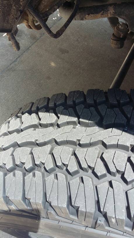

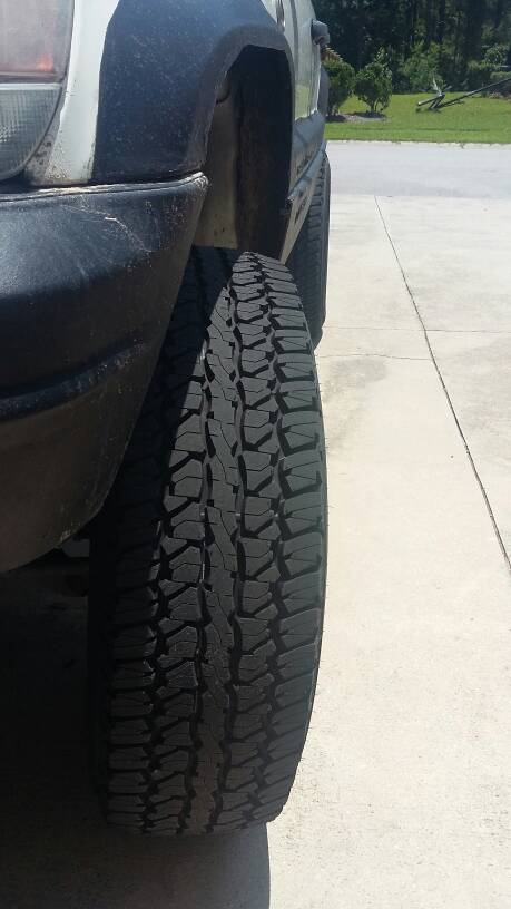

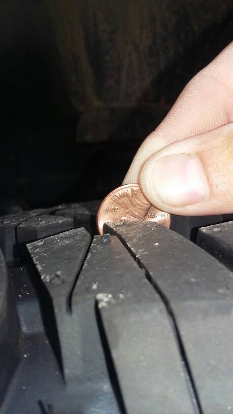

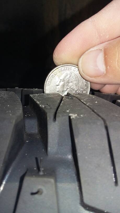

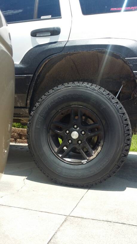

Having some Firestone Destination A/Ts put on.
Not the muds I wanted, I was gonna wait another month, but have a big trip coming in a day or 2 due to family death.
These were only $148 each and best deal I could find to be put on with short notice.
