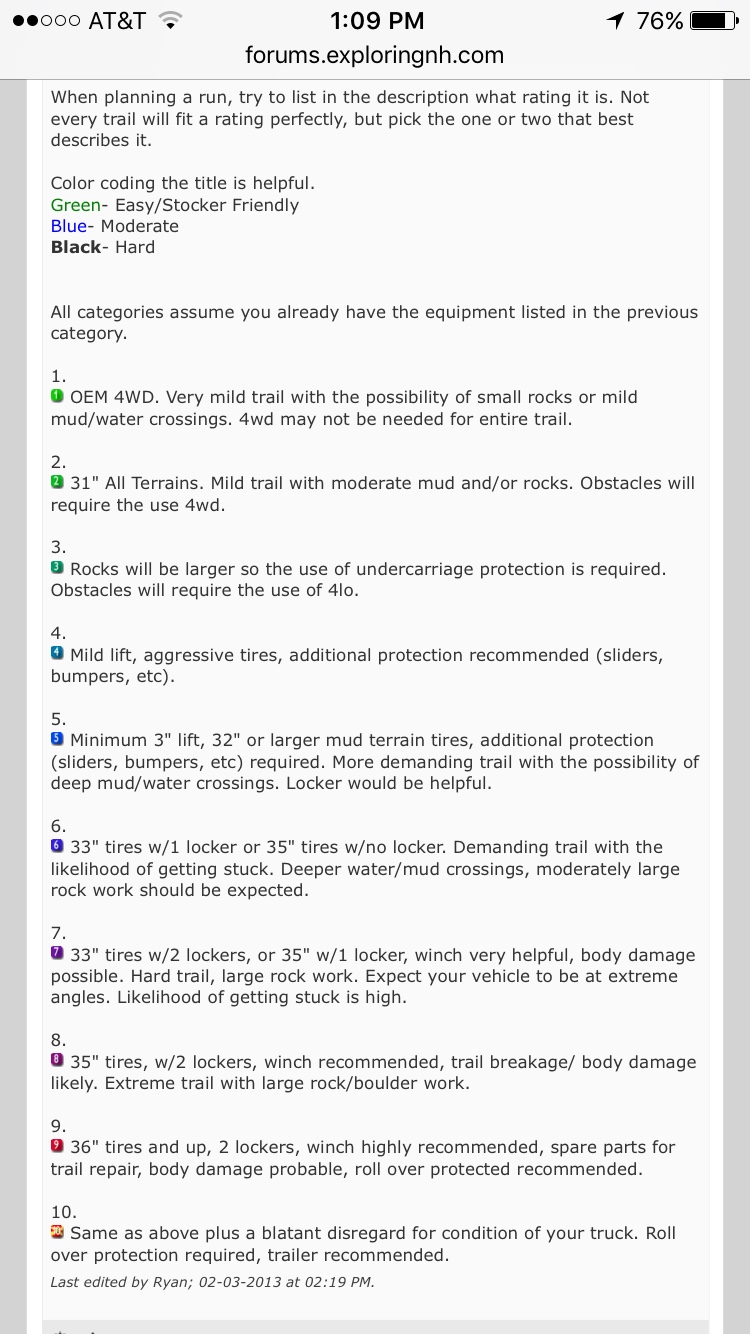

This is from another thread, but I thought its placement of a winch was interesting.
Admittedly, it probably applies more to wheeling in groups, and definitely seems to be more geared toward wheeling itself rather than long-distance exploring. But, still interesting!

Sorry, by winch mounting plate I mean the large plates that have all the holes, meant for bolting or welding to the frame rails to serve as the basis for the bumper. I will be welding mine to the frame rails, and building the bumper around it.
Indeed, on trips where I expet I might actually get stuck, I'll still have the winching chains for winching with the hi-lift in reverse. Though, referencing the chart above, most of my wheeling is going to be in the "2 to 4" range, so Id be surprised if I use the winch more than once a year.
