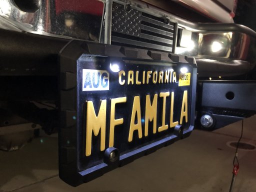

Since the license relocation frame did not come with license plate lights, even though Wilco sells them, I decided to DIY with a pair of LED license plate lights from Amazon for $7 instead of $75 from Wilco. I tapped into the existing reverse lights.

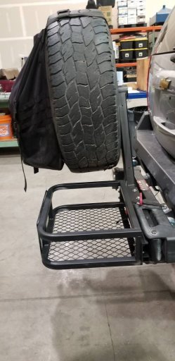

I put my WIlco on over a year ago and it has been fine even after a lot of rough off road use. I relocated the license tag to the swing out arm by drilling and tapping two holes in the arm. I added a tag light but I haven't hooked it up yet...
Recently I added a flip down / slide out table to it and a trasheroo. I am working on making a 12x14 water / fuel can carrier so I can mount a jerry can or a reliance square or tall 7 gallon water can just to the right of the tire. I may add a Roto pack mount over the table behind the tire for water and or one behind the trasheroo... I am still deciding on those still...

Good question. I haven't driven it enough to tell the difference to be honest. Since I put the carrier on I've only driven it long distance (50 miles) just once or twice. My 2500 feels just as heavy lol. I removed the spare OEM tire from underneath the truck since I wasn't going to use it so a small savings there. But no concerns as the moment.

I have a XL on mine the solos are rated for 150lbs of total weight.
My 35x12.5x17 and wheel weigh out to 84 pounds the table is about 18 pounds 102 total. The main concern with the swing out is the dynamic load generated holding up tire and fuel on the upright arm.
The carrier with 7 gallons of water is about 83 pounds. But, the weight is not on the upright arm it is supported by the horizontal support arm that is heavily reinforced so being a little over their suggested weight should be no problem at all.

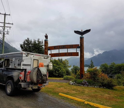

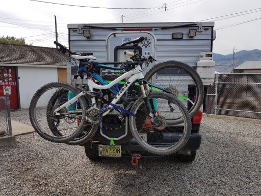

I have the standard Hitchgate (offset) and it has proven itself to be 100% reliable and so far been worth every penny. My options for a swing-away bumper were limited (as in none) given the camper on my truck. My only other option would have been a full custom swing-away bumper. I have nothing but good to say about the Hitchgate. It's now been on the truck for close to 40K km of travel, including thousands of miles of bumpy forestry roads, up and down the Dempster, and many off-road trips.
I also recently bought us a couple bikes, so I've now added a bike rack to the spare wheel and can tote our bikes around with ease. This set-up has also proven itself solid and reliable (I do run a seperate strap from the truck bed to the bike rack....just to keep my paranoia in check with our "new to us" bikes on the rack and I dont run the fuel tanks on the Hitchgate at the same time as the bikes...to keep the weight down).

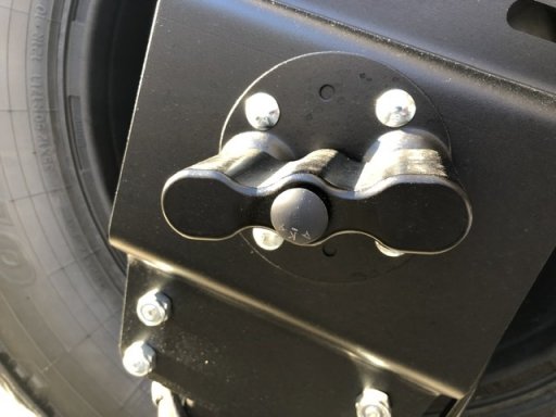

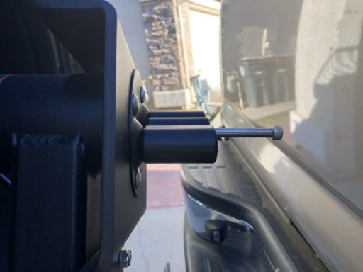

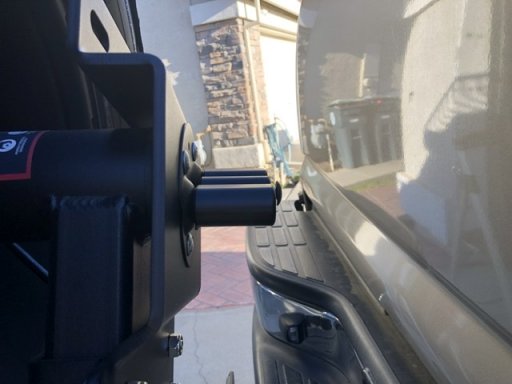

Mine has 2 holes (I think). It's as close it it can be, the wedge lock is at the far end of the receiver inside.
Yup so is mine. Just moved it to the closest hole over the weekend. Maybe I just need to buy more stuff to fill in the gap. j/k.
RoarinRow
2,771
Elk Grove, CA, USA
Rolando
Nispiros
17011
KN6JJS

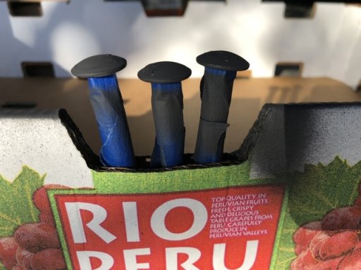

When I am not using the FuelPax container I put a bolt where the locking mechanism is so dirt doesn’t build up inside the hole. I had this long 5/16 bolt lying which I used temporarily.
Today I bought a 1 1/2” hex bolt, painted the top, lubricated, then replaced.
