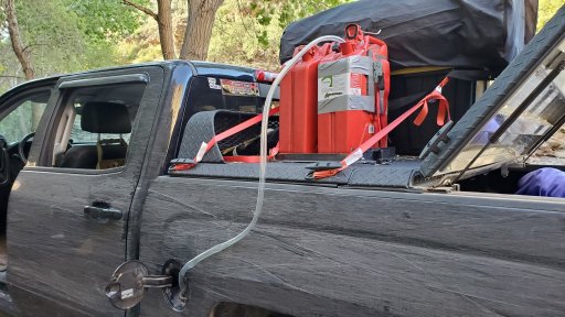

Gotta agree with ya about the extra 10 gallons. Before my last trip I fabbed up a couple of mounts; 1 for two 5-gallon gas cans, and another for two 5-gallong water jugs.
I mounted the gas cans on the drivers side so I could easily fill the tank with 10 gallons of juice without having to remove the gas cans.

That pinstriping is righteous!
I looked at that pinstriping and thought the same thing, but then saw the door handle and a small section near the edge of the door was not pinstriped - like it was super dirty and someone had cleaned the handle and touched part of the door edge? And yet, the dirt looks pinstriped. So, is it tore up, and the handle was replaced?

It's just dirty, and very well pinstriped. The Door handle is a little cleaner due to me grabbing it, and you can see where I close the door with my finger tips. Here is how the pinstriping happened.
Those gas tanks, and water jugs sat on top through all of these branches.
