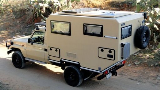

Want to be able to go exploring without having to break camp, but don't feel tents are secure enough, and pulling a trailer is too limiting?
I just saw this on Pinterest...
Imagine one of these on a CrewCab Tacoma.
