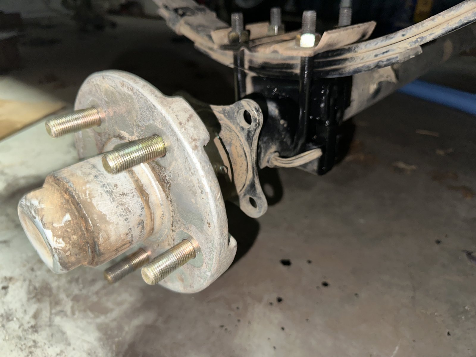

Not my rig per se, but my teardrop.
Like most vehicle projects, it’s never just a simple matter to swap something.
I only wanted some tougher tires. But no, the smallest 14” all terrain tire is 27”. The ones I had that keep getting rock cuts, were just under 25”. Eh, no biggie, I actually had clearance under the fender.
but not the lip.
I could have done some spacers to slide it out a bit. A friend @2WheelRob mentioned blocks at the spring perches to lift. Yeahbut, the axle was on top. It’s also crowned so no flipping it like I originally intended. But I started looking anyway.
Viola, Dexter makes an accessory to do the under-over conversion. It’s bolt in, but recommended to tack weld it after installation.
Before. That’s only the spring perch with the notch.
And after.
Before and after, with the frame level in both. The new tires give an inch of lift. The axle flip gives 4“.
but not the lip.
And after.

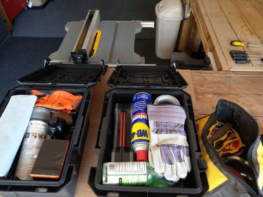

Reorganized the gear. Got a couple of the Plano tactical ammo boxes and used one for everything general repair, the other for everything tire repair & air up/down related. Used the Dewalt canvas bag for recovery stuff.
