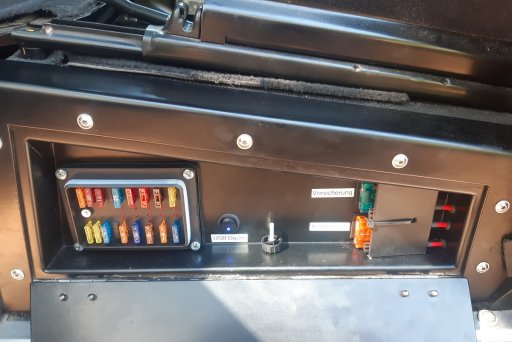

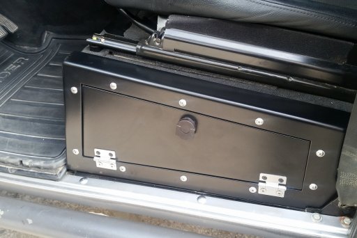

The project rewiring of the 12 volt auxiliary electrics finally completed. Some time ago I had already installed a box for it in the side of the seat box. Now the rewiring was done. It is important to me that such a thing is done by someone who has learned and deals with it every day - only then it will be safe and good. I was able to win someone for the project who knows electrical engineering very well, has built numerous rally cars and made entire wiring harnesses for vehicles. And I think it turned out really well.
All fuses are now easily accessible from the outside (on the Defender the battery is located under the seat), the distribution is done via two bus bars inside the box, the compressor is wired separately with thick cable, so that there is also proper power. The last step was the label with the documentation of the wiring and the fuses, which I have glued on the flap. Now I'm looking for a good way to store spare fuses for the pre-fuse and the compressor fuse in the box (the smaller spare fuses are stored in the fuse box on the left).
A few photos...

That looks very tidy!

WoW! That looks FANTASTIC. Looks totally factory, especially with the Data Plate!
Very Nice!

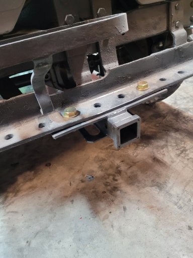

Receiver hitch bolted to the draw bar. There is no official CJ2 towing capacity, but the military MB and M38 were rated for 1500 lbs cross-country and 2000 lbs on the road. And the civie CJ2s were rated for a 1200 lbs draw bar pull for agri work.

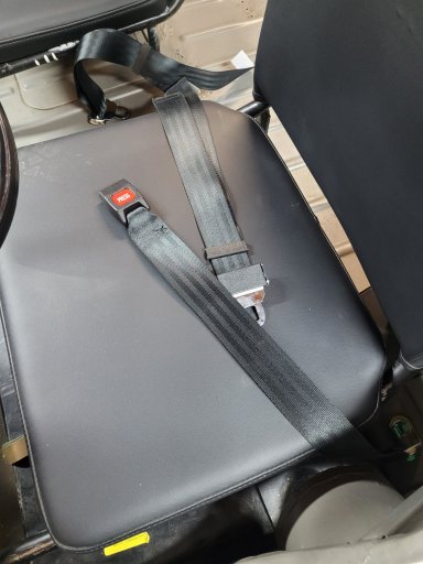

The most this will ever have to pull is a small flatbed or the M416, so well within that capacity. I also got the front lap belts put in. Still waiting on the upholstery shop to finish the rear bench seat before I put the rear belts in. Each of the bolts holding the hitch on to the draw bar are 3/4 inch grade 8 which have a proof load of 40,000 lbs and a shear strength of 50,000 lbs. To put that into perspective, that's about 18 CJ2s per bolt. I'm pretty sure the Jeep will break in half before the bolts fail. I figure 2 bolts/nuts are easy to take off when I want to use this in areas where departure angle might be an issue.
