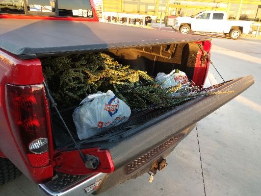

Everywhere is selling decorations of red pickup trucks carrying a Christmas tree. So, I thought I'd just do my own.
