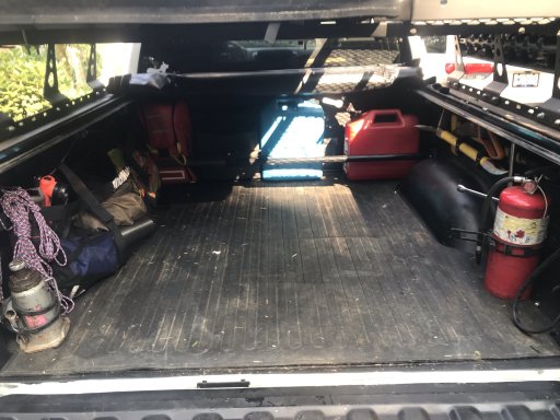

Finally decided where to mount my rototrax, Reclaiming some room in my bed.
I was thinking about mounting 1 set of X-Bull clones the same way, and leaving my 2nd set in their bag as additional spares. I have a low profile 'bed-box' in that same position, so they would be accessible from either side. It would keep the majority of the bed box empty and accessible for other gear.
My truck is old enough to not have a perimeter bed tie down design incorporated into it. So not being a metal designer/welder, means rigging up shovel or particular jack carry points are thoughts instead of reality. At one time I tried to mount a Hi Lift jack along a bed rail. It worked until I took it off-road. It's weight actually caused a small crease in the beds outer skin. Luckily it was pulled out by a body man. I had used modified C-clamps that can attach camper shells to pickup beds. Anything with weight will need support off the bed floor to avoid pulling out sheet metal fasteners.
