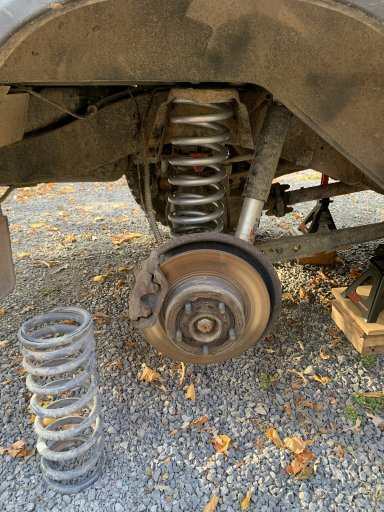

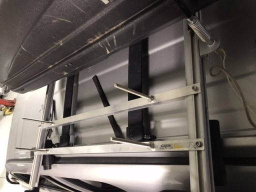

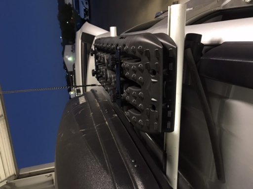

Shiny new parts on a dirty vehicle. New Heavy load springs all around, the bump stops should get a break.
View attachment 171792View attachment 171793
Thanks for giving the old girl a new lift.
Keep her on the road. Too many are bring left to rot from lack of care. If I had the space I would buy up every LRD I could find for recycling parts to keep all the LRD lovers in parts. They will never make them again in such a classic form.

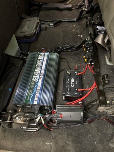

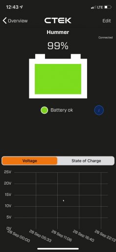

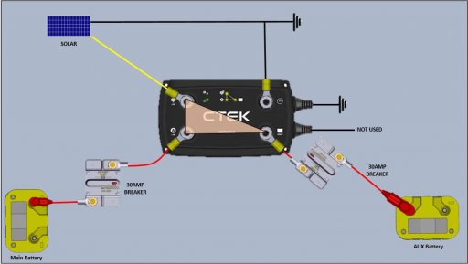

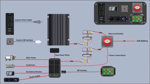

Finished my Aux battery install, I used the CTEK 250SA DC to DC charger which feeds my 100 AH battery. This feeds the 3000 Watt inverter, a Switch bank for aux components, and a 12V and USB charge points located on the control panel. I still need to improve the control panel as I feel the plastic was to thin for my needs. I added the battery blue tooth sensor with app but I will prob remove it as my battery went down over 20% since it was installed . I will see how it works when I add the solar panel to the CTEK later in the week.
RoarinRow
Awesome, that's a lot of power!
