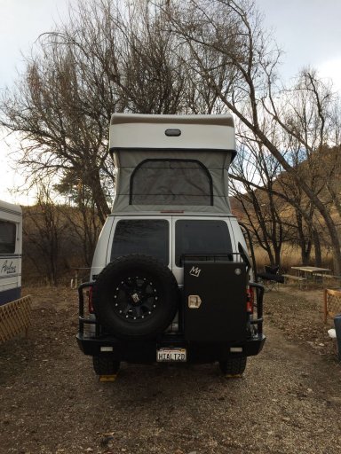

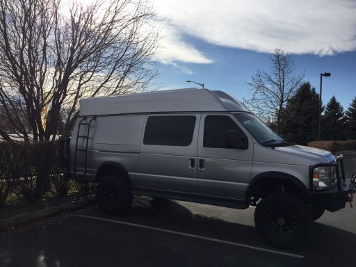

Lov'in my new penthouse top from Colorado Camper Van. The guys at CCV did a great job. Everything was finished very cleanly and worked perfectly.
Being 6'-5" tall, I went with the high top. I love the added head room (I can actually sit up in bed) and longer bed length (7'). I also love that we can store all bedding in the top while it's down, which saves a ton of room below.
I went with the insulation package and was glad I did as the first night testing everything out it was 26 degrees. I slept fairly comfortably in a good quality sleeping bag and no heater, although it will be one of the first items added.
Next is a seat upgrade, then some interior cabinets, fridge, stove, port-a-potty…

Great rig ! Is it 4x4 as well ?

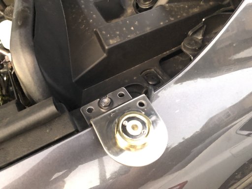

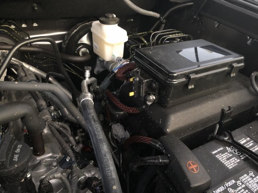

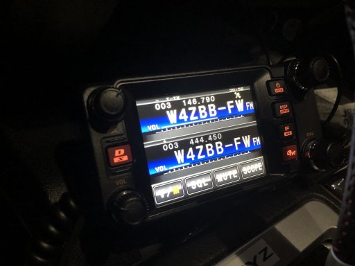

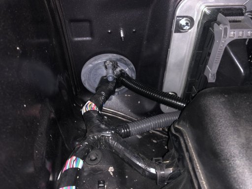

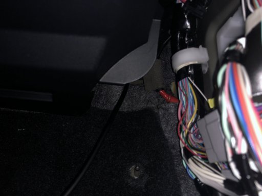

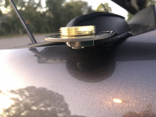

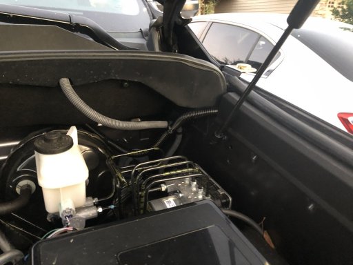

Finished installing the Yaesu FTM-400XDR radio tonight. So far pretty happy with the install even with a Fender mount. Ran the coax through passenger side firewall to keep from coiling the cable and to keep away from the power wire that I ran on the driver side. Also, I took some pictures of the distribution block I setup a few weeks ago that I ended up connecting the power and ground to for the radio. Since I was fishing wires, I ran 8 more through the firewall for six different future switches and a power and ground for future GMRS radio. I may need to provide a better ground for the antenna with a flat strap. Fairly productive evening, mostly working with all the freebie Harbor Freight LED lights for lighting in the dark lol.IMG_3157.JPG

Finished installing the Yaesu FTM-400XDR radio tonight. So far pretty happy with the install even with a Fender mount. Ran the coax through passenger side firewall to keep from coiling the cable and to keep away from the power wire that I ran on the driver side. Also, I took some pictures of the distribution block I setup a few weeks ago that I ended up connecting the power and ground to for the radio. Since I was fishing wires, I ran 8 more through the firewall for six different future switches and a power and ground for future GMRS radio. I may need to provide a better ground for the antenna with a flat strap. Fairly productive evening, mostly working with all the freebie Harbor Freight LED lights for lighting in the dark lol.View attachment 129771
Really like the illumination, My old eyes would love to have that set up.
My middle-aged eyes love the illumination lol. I even turned it down one notch from default. Very good contrast. Just wish it had an auto illuminate input from the truck for when the lights are on though.
That is a very clean install. I dig your distribution center. What did you use for the waterproof case?
