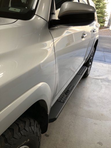

Finally finished the rockers and with them all the plastic cladding on my rig. SO happy with how it turned out. Next is to buff out the pinstriping with some toothpaste and a microfiber cloth lol
Please forgive the crappy spare tire on the right rear - the replacement AT2 is coming in early November.

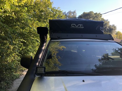

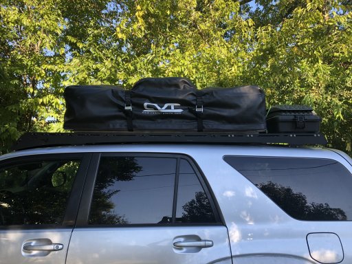

Did a lot of work on the 4runner this weekend. Didn't really take pictures though. I had a feeling I had at least 1 frozen brake caliper, my fuel economy had recently dropped like 30%, and the vehicle wouldn't go forward when in drive unless I hit the gas. Found one of my rear wheels so completely seized that I couldn't even rotate it when it was lifted off the ground and in neutral.
So I rebuilt the brakes on that corner completely with new pads, rotor and caliper. Then did new pads and cleaned up the slide pins on the other side. Front brakes were fine.
Then I cut down the snorkel by about 1.5" so its below my roof line. This is an LC 80 snorkel that basically fits the 4runner, but over time I've just noticed the height and cocked head and they didn't look right. It looked odd and was bugging me. I also heated it up with the heat gun, and got the head perfectly straight instead of leaning over like it was. These pics are at odd angles, but the top of the head is now perfectly level with the top of my roof rack.
Then my wife helped me get the RTT back on the rack, in a slightly different configuration than before.
Before the RTT was all the way in the rear, tool box in the very front. Now, tool box is in the rear, RTT in the middle, with a tiny bit of space in the front for gas cans if we need them. I don't know if I like this new configuration, but we've got the first of 4 or 5 trips this fall happening next weekend, so I think we're going to realize pretty quickly if its not working.
