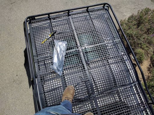

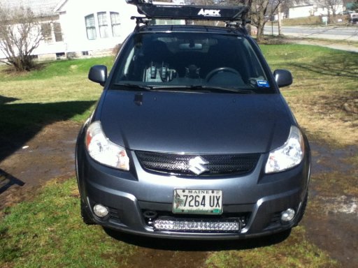

@Zargon I'll be curious as to how noisy that chicken coop decking is compared to without. Especially at highway speeds. I mounted the Prinsu rack this week, and I've considered those for decking material.
Reactions: Zargon
Zargon
The SD rack is a very noisy roof rack normally (howling at anything past 60mph), but laying down the flooring has made it nearly silent! Due to it being petty well cinched down and it's rubber/plastic material it doesn't rattle at all either. The material flexes more then I was expecting while standing in-between supports but still feels very solid.
Overall I'd definitely recommend it as flooring. Lightweight, reasonably cheap, easy to cut and install, and quiets the rack down.
Good information, thanks! In this photo, you can sorta see where the cross bars are located from the reflection under the side rails. There's 8" gap between each bar. I'd imagine that would provide plenty of support.
Reactions: Zargon
Zargon
That would definitely be plenty of support. The SD rack has very large gap between the rails (roughly 10" X 24"gaps) so the flooring is having to do some extra work.
