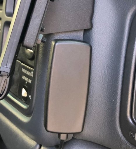

Installed it by the passenger foot well because antenna not really long enough. But this is ok cause then I can see status light when I need to.
This in the inside antenna, which I place right behind my phone cradle. Instructions say it could be 1-2 feet away from phone.

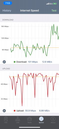

I tested the speed while I was stuck in traffic on the way to work. This time big difference is speed.
On AT&T’s 5Ge which is another LTE name. Weboost on.
With Weboost off.
