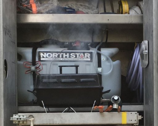

I have this 25 gallon ATV sprayer tank that came complete with 2.2 gpm 12 volt pump, hose and wiring. It was on special offer at Northern Tool. I also bought the 15 gallon model for the shower room. It is certified for drinking water use and seems pretty tough.water.JPG

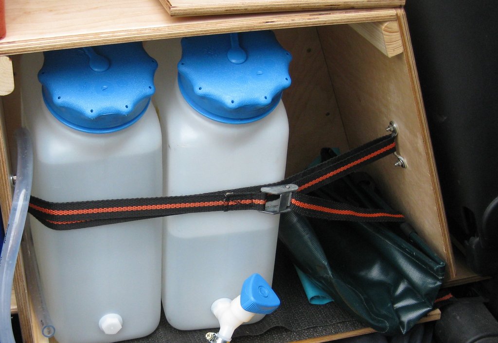

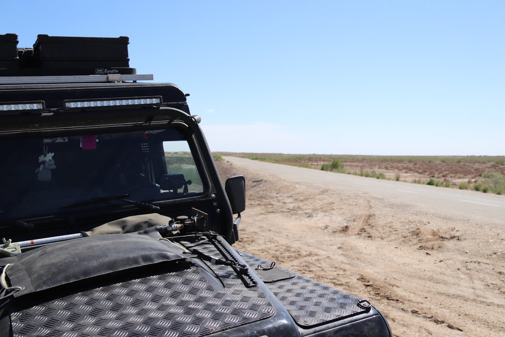

My personal setup for two are 3 canisters with 10 liters each plus in more remote areas an additional canister with 10 liters from which I filter water into bottles if necessary. Also also I carry the mentioned 20 liter fleixble reservoir for showering and a 5 liter flexible reservoir from Ortlieb just for washing hands on te trail and in camp. For additional drinking water we carry several bottles and sometimes buy 5 or 10 liter bottles in the supermarket just for drinking purposes. All depends a bit of the trip, duration and destination.
Place for 3 canisters behind one of the rear doors:
Warmwater fleixble reervoir lives on the hood:

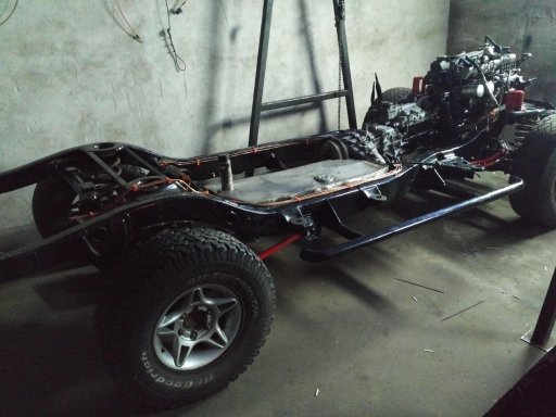

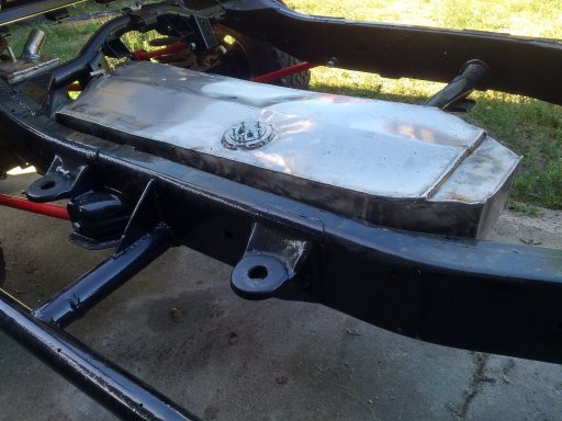

Here is how I've done 100 litres water storage in my rig.
Advantage is - low gravity point and eficiency in interior planning

Are these purpose built reservoirs for vehicles or just something you have invented? If purpose built... link?
