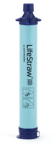

I carry a couple of the life straw water bottles with me but I'm looking at getting a SAF H2O system for the rig. That way I don't have to carry as much with me from the start and it's easy to refill.

My exact current setup and thoughts exactly. I do also carry a lifestraw because I'm a gear addict and I love redundancy.

IF I need water that bad, I will either use my LifeStraw or my Sawyer water filter to get me by until I can replenish my stock. AquaPure tab goes in after I filter it usually even tho it's technically not needed. I have resorted to filtering through a bandana to get all of the particulates out and then I boil. I tend to refill my water whenever I can from a safe source tho to not have to worry about running out

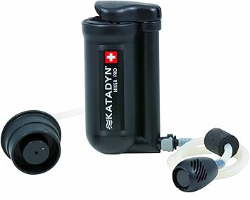

We have a Katadyn Hiker Pro. in the rig and on hikes. We also have a 20l water container in the rig we fill this up every time we come across a campsite with tap water.

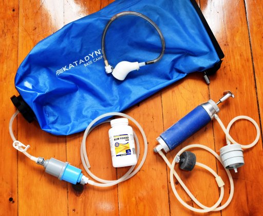

A little background on us; Before getting into vehicle based exploring we were heavily involved in wilderness canoeing. The vast majority of our trips involved extensive portaging of our gear and canoes so hauling containers full of water wasn't an option for us. We relied on filtering all our drinking water.
Below is a photo of our system;
We totally agree with the convenience of a hanging gravity filter for in camp use. The problem with any filter is just that, the filter. Most off the shelf units have a paper element, including the Katadyn Basecamp. These are a one use then throw them away unit. Depending on your water source the life of this type of filter can be very short lived, in some cases almost immediately. In the canoeing genre there's a well known hack to improve it. Take the paper filter and cut the filter part off, leaving just the plastic base in order to be able to use just the bag. Put a Sawyer inline filter downstream from the bag. The Sawyer can be easily back-flushed when it starts to plug, and ALL filters will eventually get enough silt and tannin in them to plug. The pump unit in the photo is also a Katadyn but has a cleanable ceramic filter, very expensive initially but saves money in the long run. We use it during the day when we don't have time for the gravity filter. Also in the photo is a bottle of alum. We use it in extreme conditions where the water is full of silt and will plug any filter instantly. I'll include a link to a video showing its use.
If the water is fairly free of silt and debris we don't bother filtering it for cooking and coffee, boiling takes care of the bad stuff in it.View attachment 40654
