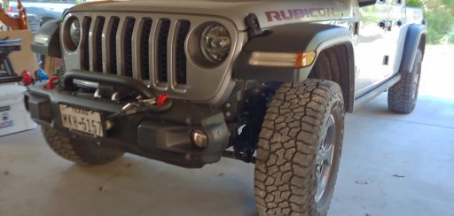

I've only had my Smittybilt X20 10k for a handful of months but I've used it 4 times already. It worked perfectly to pull various vehicles uphill and out of jams. It's very slow going, however, which makes me wish I could have gone with a larger unit but my bumper won't accept a larger case. The controller box had to be removed and remotely mounted which is the main reason I went with the Smitty. A fixed top mount controller box would have interferred with my trucks active grille shutters and you can remove them without setting off the SEL light.
With the bottom support for the active grille shutters cut. If the controller box was mounted on top of the winch I woukd have to remove the lower shutters which is a big can of worms.
Pulling a broken axle Wrangler up the hill on Snake Lake Trail
