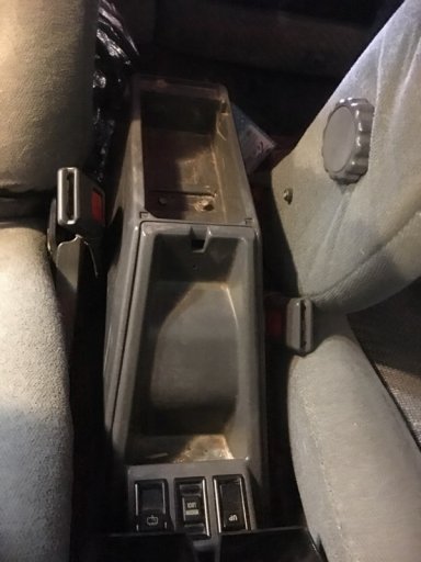

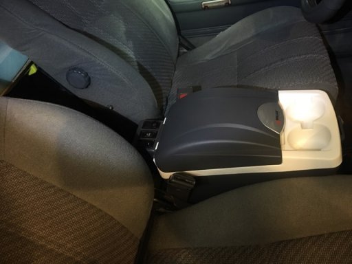

So I finally got around to installing this cooler. I decided to put it in between the front seats and replace the factory center console.
The factory console is not so much a console and is really just a cover for the rear heater. Since I have a sleeping platform and no rear seats I decided it had to go. image.jpeg
The Wagan cooler weighs 4.6lbs and the console/heater came in at over 8. So quite a bit lighter.

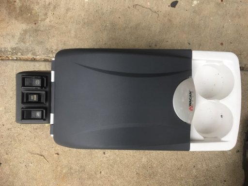

One issue I had to tackle was relocating the rear window and wiper switches which attach to the factory console. One thing I disliked about my sleeping platform was not beng able to operate or even reach the window switches. What I did was bypassed the control relay so that I can operate it without the key. I then cut the window switch mold out of the factory console and attached it to the rear of the Wagan cooler. This makes it easy to reach from the sleeping platform.
I then extended the factory switch harness and installed the cooler.
