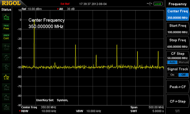

When Baofeng first showed up on our shores I was like everyone else. I got one...hell I still have it. I took it to my buddy with the analyzer and we checked it. It's barely within spec. Others I know have bought them and had them be way out of spec and still others got good ones. They are all over the map whereas the Big Three are consistently good. We have four repeaters here in Los Angeles that are all linked. Two of them overlook the San Fernando Valley from high peaks. It's unbelievable the amount of transient crap signals that get up there and try to open the machines. We use DPL but the receivers are being pounded daily. Sometimes when we use the machines we open the repeater and these spurious transmitted signals get into the receiver and cause it to stay open. I know I won't convince everybody but believe me, these things are NOT good radios and for a few dollars more you get twice the radio without the problems. When you buy a radio with a cheap receiver the only person it hurts is you. When you buy a radio with a sloppy transmitter you can potentially cause problems for a lot of other people. I really recommend staying away from Baofeng.

I'm not disagreeing about Baofeng quality. I do think there are a lot of people today who hold HAM licenses who never would have without that cheap 25 dollar throw away radio.
I don't disagree with what you're saying. I got the Beofeng because my son likes listening to the radio and it will be useful for a handheld radio for around camp or for recovery operations. I have a Yaesu FTM-400XDR in the truck and will be getting a couple Yaesu HTs. That being said, if my son is taking off fishing across the lake (once he passes his Technician exam) I'd rather he took the UV5R to knock around rather than a more expensive unit.
