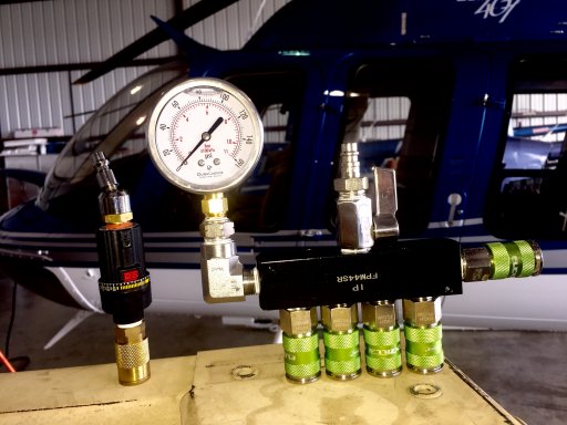

Here is a look at what I have so far, just a manifold with gauge and stainless shut off valve. With a hose running to each wheel it should be a breeze. I like where you're going with the hidden lines, that ought to look very slick. Also in this picture is my in-line regulator and swivel that brings my working PSI down to a point where my air tools like it.
That looks very PRO.

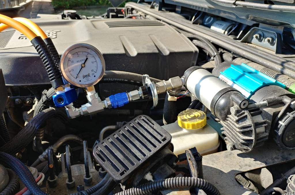

My manifold is 1in/4out only but my regulator has its own gauge so it is inbetween the compressor and the manifold. Then I go, exactly like you do, with 4 hoses to the 4 wheels. Also quick dis/connect from compressor to regulator for deflation.
But how come you're using a pressure gauge made for water/fluids? Do they also work with air? Cause I was looking and the fluid gauges are much better quality than the crappy little air gauges...

....and by the way, the inlet side of my manifold is 3\8" just for the additional volume going to the 4 - 1/4" fittings below. I am no high volume gas expert but I just thought it made sense, maybe not, but it works.......

How about the fluid gauge? I think you missed my prev post.
It's just an Oil Filled Pressure Gage, same as any other just filled with oil to dampen the vibration and needle jumping. I just find they last longer but you can use whatever gage you like.

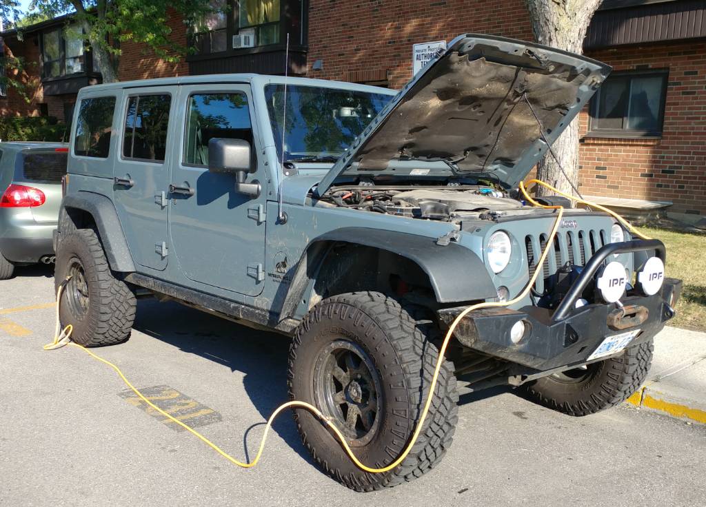

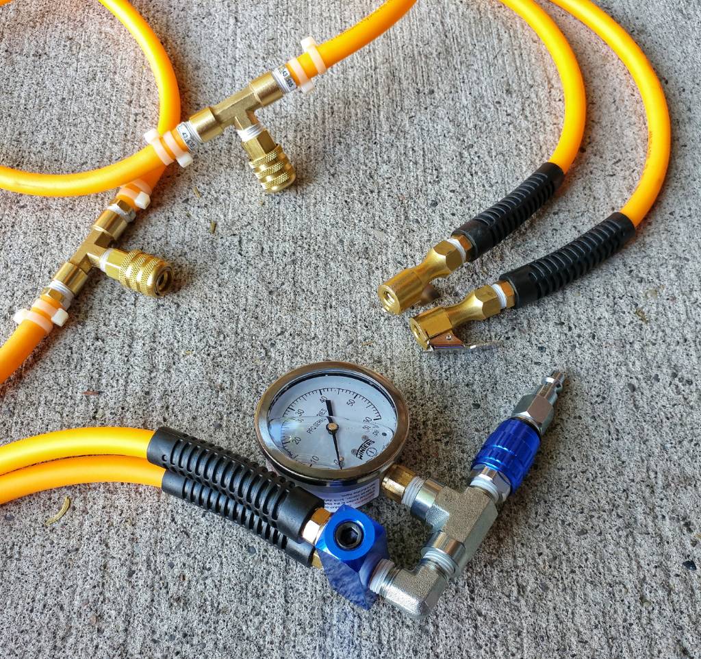

Well.. since the parts and materials I already purchased are not fit for an "internal" system, I decided to make an external one. Now, having built this one, I may get lazy and discontinue the idea of an internal system since doing it right may be a lot of work with little added benefit over this one. But who knows..
The last pic serves as a bill of materials.
The 2 hoses are 25ft each and have fittings and flex hardening at both ends.

I've tried the setup today on the trail and it did the job very well.
So are you still happy with your setup? I was thinking of just getting a shoulder strap to carry my tank to the tires the hose cannot reach. I'm just not too sure about all the extra hose, but you should know....
jeep670
Yes, I use it every time I hit the trails to deflate/inflate.
I like it for two reasons:
1. No more squatting,
2. All tires have exactly the same pressure when I'm done.

That’s great to hear. So are you still using clip-on in two of the connections and press-on on the other two? If so, what are your thoughts on each? Do you have a preference?
