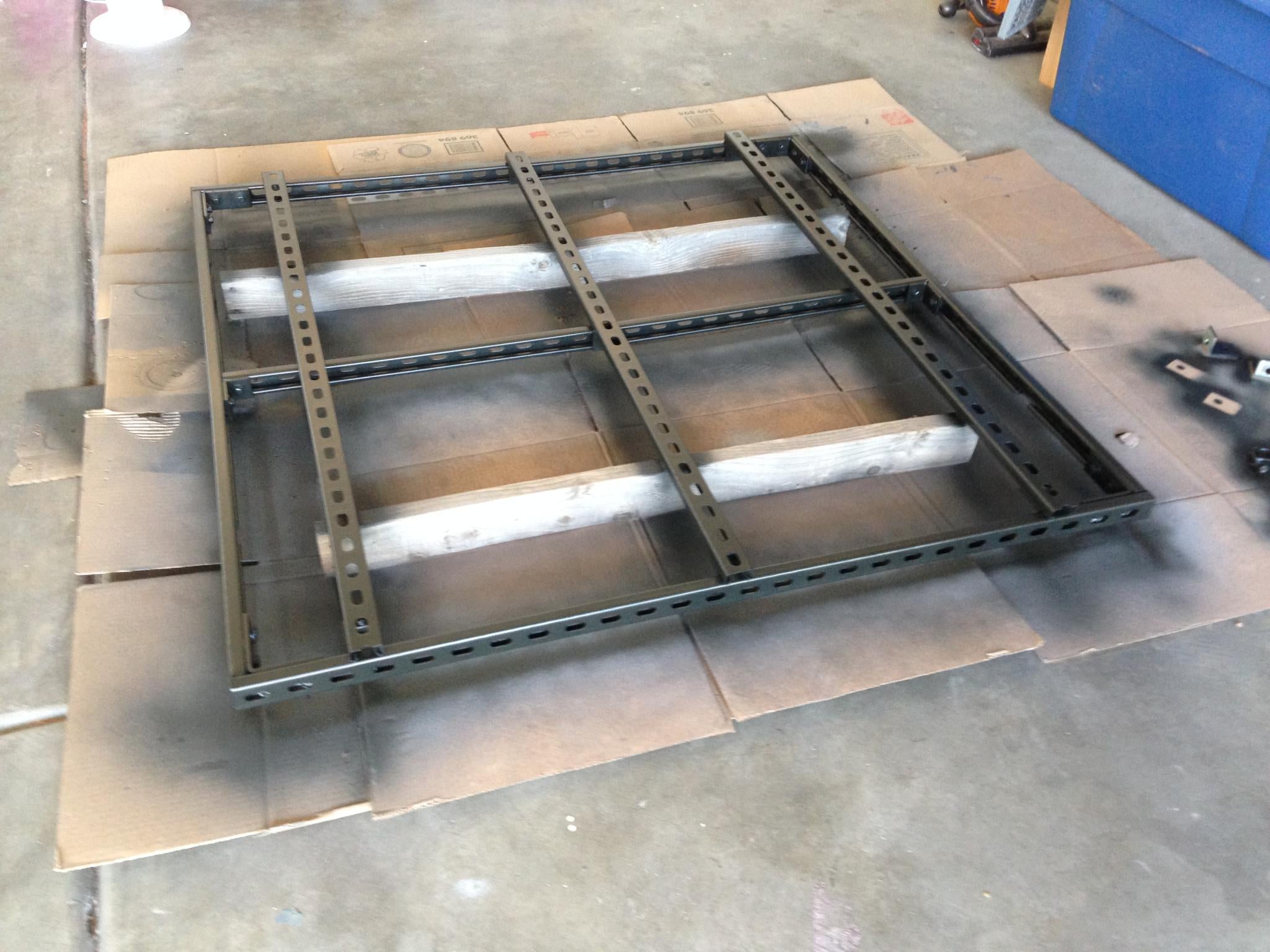

Apologies, I didn't take pictures of the process. Made a couple of crossbars made from unistrut/superstrut. Cut a 10' strut into two 4' pieces. They're galvanized so made sure to clean and etch. Primed, paint then dried. Used squared off U-bolts to bolt it on my existing roof rails. About $60, including the strut, hardware, and paint.

I made a roof rack out of superstrut many years ago when I had first bought my Frontier. Attached it to Thule load bars. Can be seen in this ClubFrontier.org thread.
Ended up taking it off because...well I'm not really sure. Just ended up wanting to change it out.
