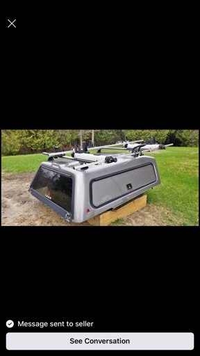

I’m currently looking at truck caps for my 14 GMC Sierra. The end goal is to run our RTT on top, wondering if anybody knows if this Leer cap can handle the weight.

Not sure I would want the weight of 2 people, any gear, and the tent up on the top of a Leer topper all night. I have a Thule TracRac style on top of mine that is supposedly good to hold 500 pounds. Then again, that rack system is meant to be gutter mounted to a metal roof of a full size van.
Not sure I'd feel good with more than 300 pounds up the there. It's just fiberglass shell. No real frame inside. Maybe someone with more professional knowledge will chime in

Yeah I'd only put a RTT on a topper if the topper was reinforced from the inside out, which I've seen.

Upon more consideration even 300 pounds seems like a lot. Id probably feel OK with 200 pounds. Mainly I'm putting up 2 kayaks. Or maybe a spare wheel - usually not at the same time. I know the rack system can take more than that, but there just isnt anything substantial supporting the wide flat expanse of roof of these Leer tops.

I can't tell what model that is, but I looked into weight limits on Leer caps a while back since I have one myself. Wasn't looking to add a RTT, just wanted to know how much I could carry up there (center of gravity concerns aside). Unreinforced fiberglass Leer caps have a limit of 120 lbs (sheer load limit). The reinforced ones have up around 300, from what I recall. Can you load more than that as a static load? Probably. Would I want to risk it? Nope.
If that one is reinforced, and you and the ole lady aren't of the hefty sortm you'd probably be alright with a RTT. If not reinforced, I couldn't recommend it.

At a 300 pound load limit, a 200 pound man and a 100 pound woman arrive at the threshold. Now add a 100 + pound RTT and whatever you have up there for gear, and you are likely to find yourself waking up in the bed of the truck some morning, or at least weakening the top and reducing its longevity.

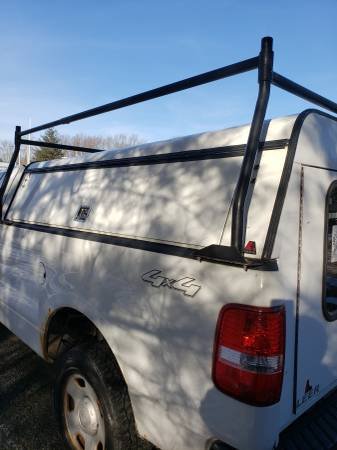

I've seen tubular racks with flat mounts that will mount at the stake holes. Put that on, and they are wide enough to fit the cap in between them and rest on the bed rails, so you have some sort of exoskeleton that mounts under the cap, but comes out from under and wraps closely to the shape of the cap and crates a strong roof rack system around and above the cap. Putting an RTT on one of those seems more sensible and robust

It is a reinforced contractor cap. I looked into this model and the dynamic load is 400lbs. I know that with us and a bit of gear In it were getting close with a 130lb tent....

If it's a contractor cap it should be fine. I went through this too and decided to make my own steel frame and aluminum siding camper shell.
