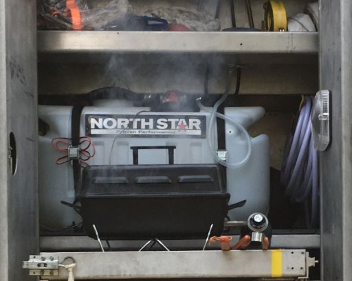

I have 25 gallon tank that is made for crop spraying from an ATV. It is certified good for drinking water and came with a 2.2 gpm on-demand 12 volt pump. I filter the water as I fill the tank with one of those blue filters attached to a drinking-water hose. This was good enough for me but not the g/f; now I also carry two 5 gallon water-cooler bottles and a hand-pump.

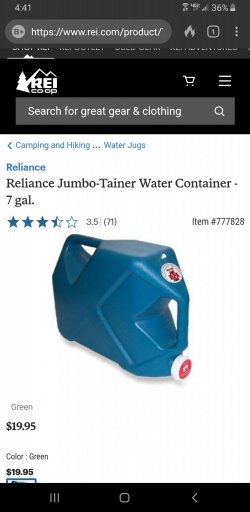

2-5 gal Scepter water cans. Nemo Helio water bag for showers, dishes. Fill camelbaks and cary a couple gallon jugs of drinking water. Also carry a water filter that I never really need. I keep thinking I need more capacity, but it is just 2 of us and usually able to find a resupply long before we run low.

Depends on length of trip for me. WHen I lived in the NW, water is abundant and usually only needs treatment and boiling. Down here in Texas, not so much. I just dont trust it. We use between 14, 5 gallon cans like above from Amazon or if its just me and my dog, 1, 5 gallon and a 2 gallon Rotopax. Lots of guys use Rotopax fuel and water can mounted inside their bed for ease of use.
