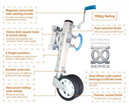

Put an XO Jack by ArkPak on your trailer and it is pretty easy to move in move situations. To date I have never gotten stuck and I have been in some pretty tight situations. Sometimes it takes 20 turns to make "3 point turn" but I have been able to turn around. Most of the M416 style trailers are pretty light and very easy to move. I understand the concern if travelling solo and don't have some type of scouting vehicle... I will say that most true "Overlanding trails" vs "Off-road" should cause no issues with pulling a trailer.

LOVE my ARK XO 750 Jack. XO stands for Xtreme Offroad. They make a 350, 500, and 750. Those are KG ratings, not pounds, so the 750 has a static rating of 1650lbs, dynamic rating of 1100 lbs. Rugged as hell, and the dual wheel makes maneuvering your loaded trailer by hand much easier. I was amazed at how much more I could move my loaded trailer (3500# GVW) with the XO jack than I could with the Fulton single-wheel, less HD, jack. I used to put a 2x8 under the jack wheel when unhooking so I could nudge it those last few inches when hitching back up, but don't need to with the XO. I've also swung the trailer around by hand, though if on really rocky, deep and loose gravel, or off-kilter grade, it would be more difficult, of course.
I bought mine from Schutt Industries, who makes my trailer. They currently have the best price out there, too, as far as I know.
Tell them Road sent ya . . . it won't mean a thing as far as discount, and I don't get anything out of it, but they like knowing where their customers come from, and you might hear a story or two. :tonguewink:
