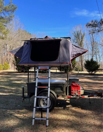

Mine started life as a mobile welding trailer. I didn't get the welder but the guy that welded the trailer frame together did a great job. Here's what I started with and although not finished yet generally where it stands now.

Thanks guys. I'm making progress. The top is now on and I'm able to lift it with actuators. Lots to do yet though ... including more ammo cans!

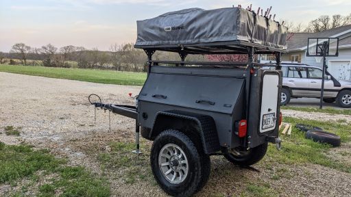

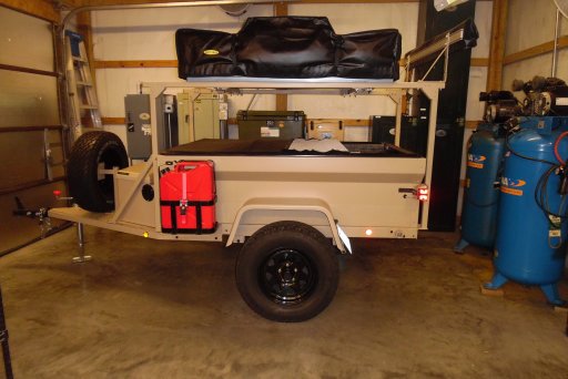

Price wasn't a issue for me building my overland trailer. I liked the ideal of building mine the way "I" wanted it. Scott also sell the demo's he builds too. I new folks who built their Dinoot's around 2,100 using Northern Tool frames w\ upgraded suspension which Scott sells. Mine I have over 5,600. into it. Your build can be inexpensive as you want or costly as you want.
Here's my trailer I built, M Series.: M416. You can go the rout of a Explore Box trailer or M Series (after M416) & the J Series (Jeep Tub) style. Scott has all 3.
Scott sell the frames or you can use a Harbor Freight trailer frame or Northern Tool trailer frame.

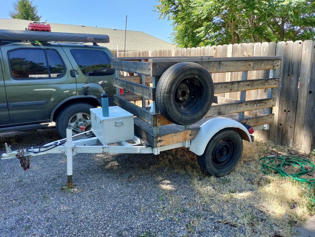

I DIY'd mine as well. Going into our second year using it.
Started off with this:
And ended up with this:
The box is built out of wood, since that's what I know how to work with. I can carry up to 21 gallons of water, our fridge, has a kitchen box, and can fit 6 68qt plano totes in it.

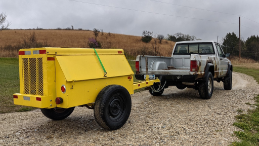

The old construction trailers were sure made of substantial materials. I used an old welder trailer from the 60's to build my camp trailer.
Before-
After-
Check out the build here: Project 'Yeller' Trailer Build
Some of the basic build includes: 3500lb Dexter brake axle, 30" tires, 11' 1/4" wall hitch backbone from front to back, some lighting and 15 gallons of water storage/filtration.

Here's how the trailer I posted above (#2) turned out. Due to another trailer acquisition, a tear drop, I scrapped the box above and built a different one. It was 4' x 6' x 18" and is now 4' x 6' x 16". It's now suitable for hauling an ATV, with the RTT removed of course (a 20 minute job). It now also has a 1 ton winch hidden on the tongue for hauling items up into the box. The original build and a bit of the rebuild are shown in my signature below.
