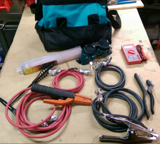

After taking the 7P Battery Welding course at Overland Expo last year, I came home and made my own to use two or three batteries.
And it is no problem to use the batteries then count on them to start the car.
During the class, there were 10 - 12 students, they all tried their hand at it and the batteries were still in relatively good shape, had good voltage, certainly enough to start a car.
I carry mine now on longer trips, I'm glad I had it last time, I had to weld my exhaust where it had completely separated.
It's true, it's not a great quality weld, but it melted the metal and got me home.

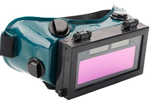

@KD7WCD, Yep, that's my next issue. I have an older hood that is an instant darkening lens that I am going to modify to make it able to fit in my bag.
Another option is to find some smaller goggles that have that same instant-dark lens, but I still have to find a way to cover my face.
Welding in these scenarios is not a long time, just get the fix done but I'm still concerned about that exposure on my skin.

So, to close the loop, I picked up these auto-darkening goggles from Amazon, hopefully they'll work out better...
This is my ho-made welder. It worked pretty well, despite my lack of stick-welding skill.
The goggles in this pic were summarily thrown in the trash tonight when the new ones arrived.
I can use two or three batteries with this, two seemed to work well for what I needed. For welding on the frame, I might have wanted three.
Dan.
