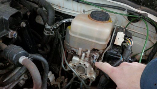

If you need to disable the traction control until you figure it out.... pull the wiring harness plug that is on the front of your master brake cylinder. This disables the VSC until you plug it back in and restart the FJ.

I'll give pulling the wiring harness for now. Does that disable anything else?

Pulling that wiring harness just disables the traction control nannies... An ABS light comes on but, with mine at least, ABS is still active. So for me, I prefer not to have ABS while driving in the city so I pull the fuse - which disables the traction control AND the ABS.
