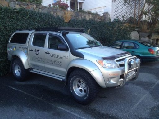

Crossing a lot of rivers during our Iceland Expeditions, requires a snorkel - simply not possible to cross theses rivers otherwise...
Fitting a snorkel to a Toyota Hilux was quite standard, but did require a hole cut into the side panel.
What needs to be emphasised is that a snorkel can only "hold out" for so long, when subject to water testing.
Unfortunately, a lot of folks believe once it is fitted, nothing can go wrong - but it can.
Always check the seals inside the engine housing, they can come loose / wear.
I think they add value to the styling - and clearly demonstrate your rig capable of a river-crossing....
You also need to remember to waterproof all your electric joints with appropriate hydrophobic electrical joint gel.
If not, the snorkel may work during a river crossing, preventing hydrolocking your engine, but you may short-out electrical circuits / fuses.

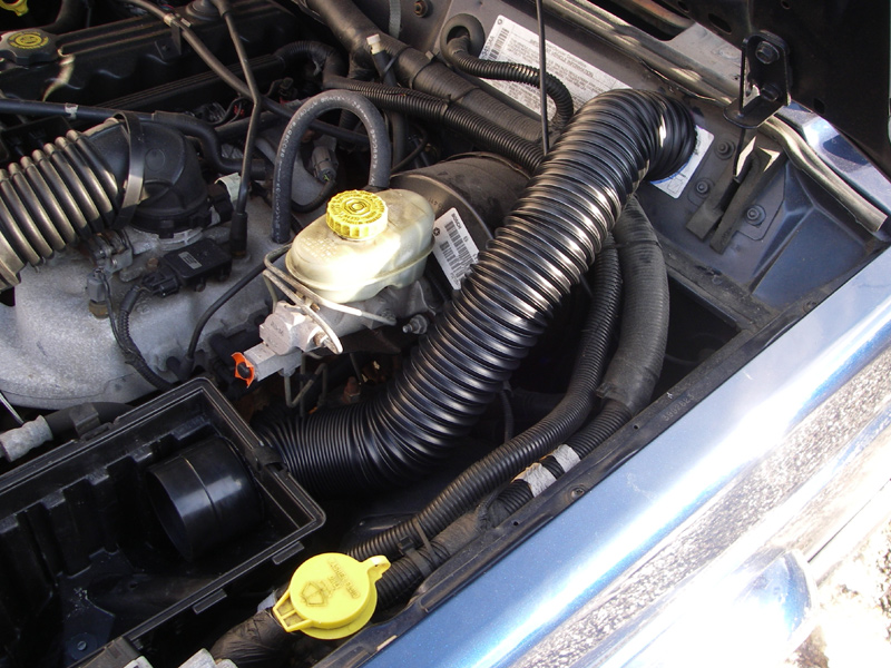

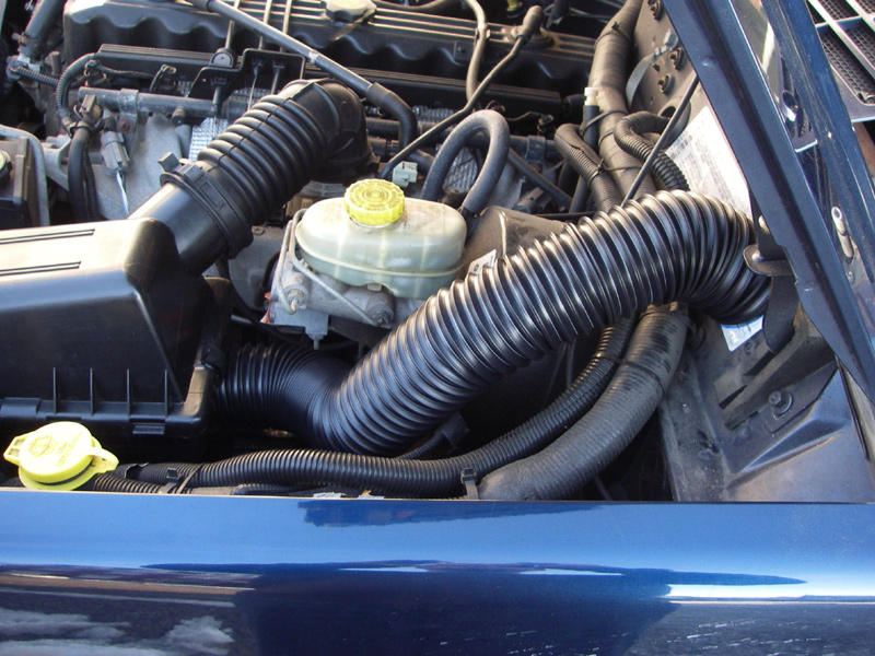

My next rig was a 2000 Jeep Cherokee. The conventional snorkel was a pain in the ass because sandwiched in inside the fender was - no, not Oreo filling - but the windshield wiper fluid reservoir. If you've ever looked under the hood on an XJ with a 4.0, space is at a real premium, making relocation more of a chore than I wanted to endure. I opted for modifying the stock air box and installing a cowl snorkel, which was a $19 universal tube from the local auto parts store and a $6 tube of high quality construction sealant from my window manufacturer.

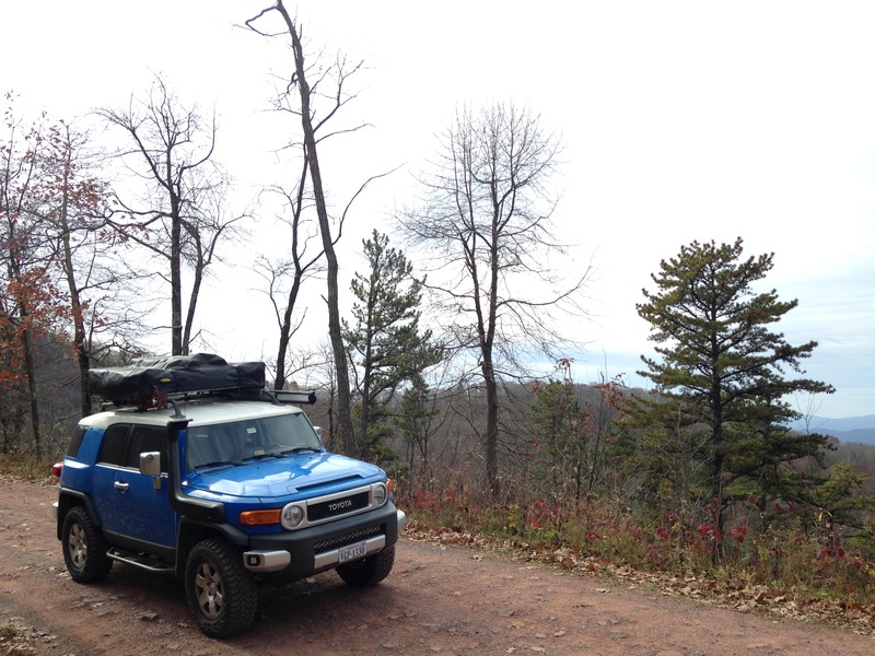

With my FJ, I just used the conventional snorkel. I considered doing another cowl snorkel, but decided with it that I'd rather throw a hole in an easily-replaceable fender rather than above the firewall. I usually don't like the look of the big fender-and-A-pillar tumor, but clearly I am not going for aesthetics or aerodynamics with this build. Aeaeaeaeaeae.
