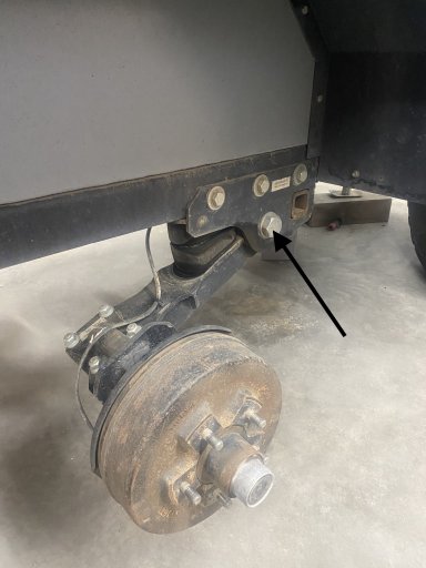

I have the long arm 2500 lb that is the same as the 3500 lb but with a softer rubber cushion. Both control arms have bushing failure causing the axle to be out of camber and caster. The fix is costing about $550 and will replace the entire control arm. No more than 12,000 miles on the axles.
Off road they are great, we have put them through some very rough terrain in the Sierras and in the desert at high speed over washboard. Really a great ride and handling.

I have the long arm 2500 lb that is the same as the 3500 lb but with a softer rubber cushion. The both control arms have bushing failure causing the axle to be out of camber and caster. The fix is costing about $550 and will replace the entire control arm. No more than 12,000 miles on the axles.
View attachment 166684View attachment 166685
Wow, that is not a good review. Have you talked to the company about what may have caused this?
OB Executive Director
Actually the product works extremely well when off road. No one knows why the failure happened and since it was not normal use the only thing to do is replace them and keep an eye on the new ones.
I have an off-road trailer with timbren axeless. I have it about 2 ish years and have done mild off-roading. It is looking very bow legged now, so it seems I might have same problem. What part was the failure at and did you source part from Timbren?
There is a bushing that is part of the control arm, The arrow in the picture is pointing to it. Contact Timbren on line and they will make sure you are getting the correct part. I purchased the parts through etrailer.com

I bet the bushing failures are a case of them under sizing the pivot bushing to streamline production, or under estimating the requirements of said bushing. Honestly stuff like this happens a lot, engineers say this off the shelf part will work, then it doesnt in the real world. Anyway I can understand why that would happen, the way the suspension is built puts a lot of stress on that busing. That one bushing does the job that 4 bushings do in a leaf spring suspension. I would look into upgrading that pivot, like run a busing from a Chalmers walking beam torque rod, or look into going to a greasable brass bushing or hell even a flat roller bearing.
