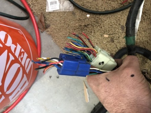

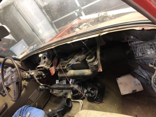

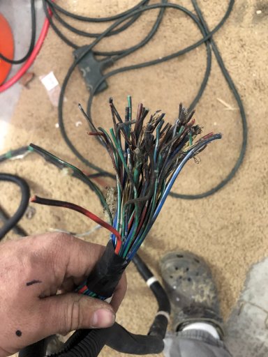

Been swamped with class so I would be out for anything happening this month and probably next. Might get a little lucky since class is all online based at the moment so my weekends that we’re busy are now “free”. Glad to see that @MrWilsonWJ is finally getting close to being done and that people are getting out to some places. I spent about 8 hrs on the land cruiser. Finally have the old wiring harness torn out and am working on trying to get the new one ready to install. Whoever took it out of the wreck one did not play nice with it and there are about 25 wires I need to splice back together and they cut the wires about an inch from 2 sets of pins instead of disconnecting them so I am going to try and find a way around that. Very slow progress but still progress. B2B30A3A-CC7F-4AAE-BF17-564C480A91D1.jpeg785BF0F8-D182-4522-8E6F-665A1B3C29C2.jpegA2E8DF39-9BDB-4FAE-A615-ACF1EA025F87.jpeg

Isn't wiring fun?? Just an idea, but if you already have to redo the pins on one side of the connector would you be better off replacing both sides with some Deutsch or JD connectors? It's a little more time but you would end up with new stuff that is a better protected from the elements.

I have thought about this. It might come to it since I literally cannot find anything that will work. Even with all of the electrical connectors on a tractor through the years it seems as thought there isnt anything that will work with these.

it would be a real PITA to change them all out, but if the harness is already out it would be good insurance to do them now rather than relying on 30+ year old connectors. Not only would you have a better sealed connectors but as long as you got everything together good it would cut down on the chance of electrical grimlins caused by looses terminals/ corrosion/ old pins. I don't mind doing electrical work but that shit can drive you nuts sometimes when you're trying to chase down problems.

I totally agree. Electrical is my worst enemy but that is probably due to the fact that I don't understand a lot of it. I know there will be somethings that I am going to have to track down to make this work and will probably be switching out alot of connectors since I am told some are different from certain years.

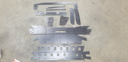

Got home a little early from work yesterday, but didn't work on anything just spent the time cleaning up some of my mess in the garage and moving parts that won't go back on the WJ out to the shed. But I did get some gifts from the UPS man! Now the fire has been rekindled to get this thing together and running so I can get it to the shop for Fab work.
DIY Trail Forged stubby winch bumper with high clearance radiator support

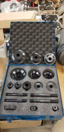

Annnnnd new toys!!!! Dimple Dye set! Haven't totally decided how I'll do the outer wings for the bumper but it will be some mixture of tube and plate so I thought maybe some dimpled holes would look good and lighten it up. If any of you guys in the TC have a project coming up and want to use these, just let me know. They go from 1/2" to 2 1/2" and are rated for up to 3/16" mild steel. I didn't buy the hand pump/ puller set up so you'd have to use a Hyd. press.

Are those N series Cummins rocker boxes in the back ground?

Big cam 400. Lost the chrome on a cam lobe, but my guys didn't find it until after they screwed up a valve adjustment and bent a push rod.... has reman heads for it and cylinders look good just needs a new cam and do the lower end bearings while it's out. We had a spare motor we put in the truck so we'll have this one put back together and keep it around to put in our water truck, its starting to get pretty tired
