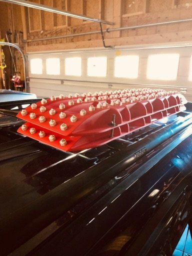

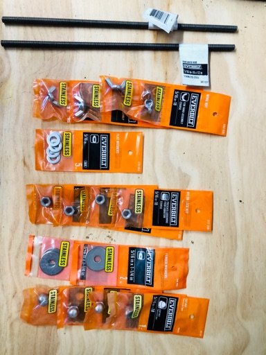

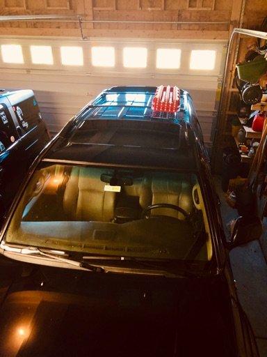

I didn’t like my recovery boards taking up space in the back of my 4Runner so I went to the hardware store and for about $40 got stainless steel supplies to mount them to the factory rack. One of the lock nuts stripped the threads halfway down and ruined the all thread so I’ll get another to have 4 mount points.

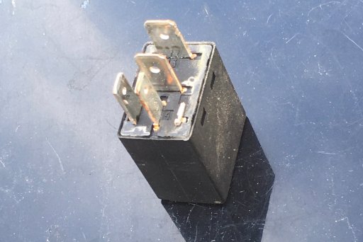

I use the fog light function as a switch for my A=Pillar and rooftop Light Bar and I hated the highbeam override. Then I found out, break 1 terminal off the relay and they now work in lowbeam and highbeam.
That's something I've been wanting to figure out for a while! Got brighter pod light for my fog lights that act more like flood lights but I can only use them without the brights

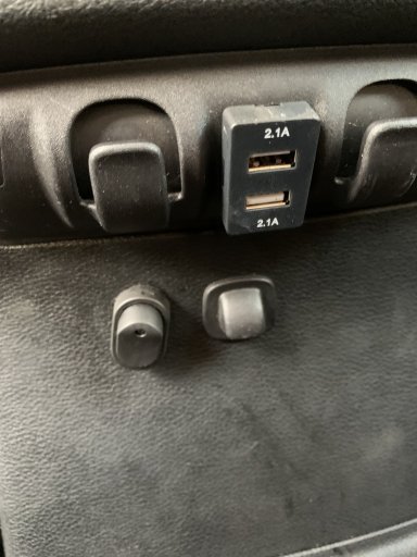

I installed a 2 USB port I got from eBay into the back of my console. I pulled power from the 12v port inside the console. What I didn’t realize was that power is always on there. To remedy this I wired in a switch.
