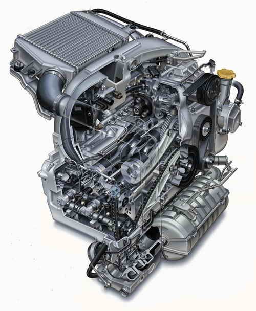

I'm waiting on a locking differential solution until I get my hands on a 4.44:1 rear diff & auto trans combo. Wish the Aussie spec "dual range" trans came in a 4.44 auto. I think it would be fun to build up & modify a Subaru auto: Manual valve body, bored out ports, upgraded converter etc. I have a line on a few engine options for it too, & as much as I want a diesel boxer engine swap to fit with the style of the build... but from what I've looked into they do not take well to modifications like most diesels. So it's a toss up now between H6 or WRX power.
I'd honestly stick with a EZ36D. Good hp and for the purpose with the ability to still use 87 octane, plus better reliability from N/A.
The wiring can get a little tricky, but yeah it would be much more simple under the hood vs turbo for sure, and loads of torque!
