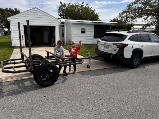

If I may suggest, continue you tongue tube thru to the rear so you have a good strong tow connection point if you need it
Finish it with a d-ring, or a 2 inch hitch receiver
That’s the plan. I have another section to weld on. It’s been slow going by myself. Plus, I’m not a fabricator so I am working at the pace of my abilities. If anyone in southern Florida wants to lend some expertise that would be awesome.

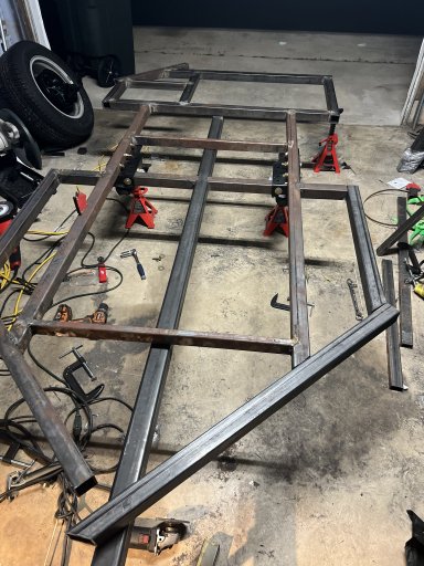

It's getting good now. Subscribing! You are essentially building the same trailer I've been mentally designing. I look forward to watching your progress.
What material size did you use for the frame?

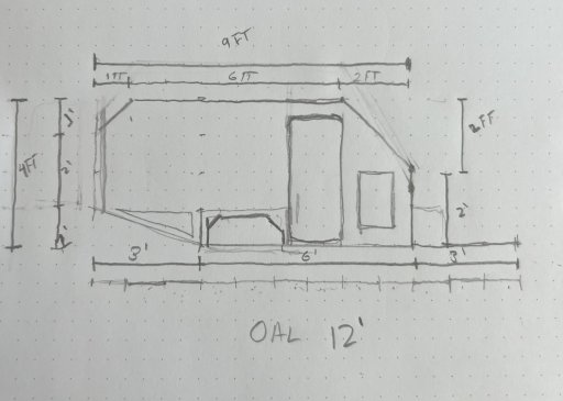

You can get a free trial of sketch up for 30 days. It is very helpful with the vision. I used 2x2 .125” for the frame. The tongue is 2.5x2.5 .25”. Everything else will be 2x1 .125 or 1x1 .125”. I have been stick welding with 6010 and it is extremely strong. Working solo is tough especially when fabricating the wall frame.when You stare share your thread so I can check it out!

Oh good! It helped me prevent wasting materials. Plus it provides a lot of motivation. I ordered my axles and said "well... no backing out now."
