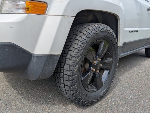

A month of driving in now and she's all good. It hasn't driven this good since we bought it. I am looking at new tires, and possibly the daystar lift. Anyone who has a pat out there it's worth your money to get appcar diagFCA. We have it, moved out daytimes to low beam not to blind drivers (soon moving them to the signal/marker lights when I get LED in them), changed the tire size to 235/65/17 diameter so that the transmission shifts correctly, the rig is not as high strung anymore and the speedo is right on the money with GPS speeds. An added bonus is that since it shifts correctly, we are getting better gas milage now. Also, I have maxed out the power going to the headlights and it is noticeable in the night. You can do one headlight at a time and see the differences.
Now, to curtail the rusties that are forming. We are taking the bottom cladding off, removing the rust on all panels, putting bedliner under the cladding and then painting all of the areas affected to get some extra time with the jeep. Hopefully we can get another 3 to 5 years out of it without rust screwing us over.
