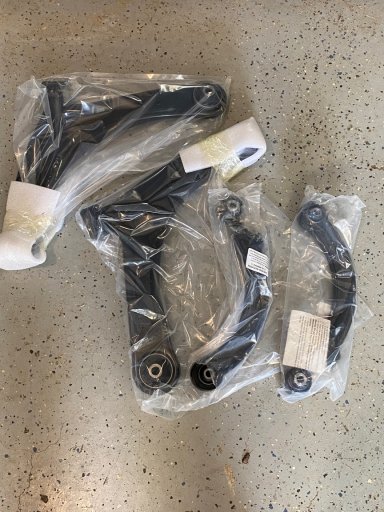

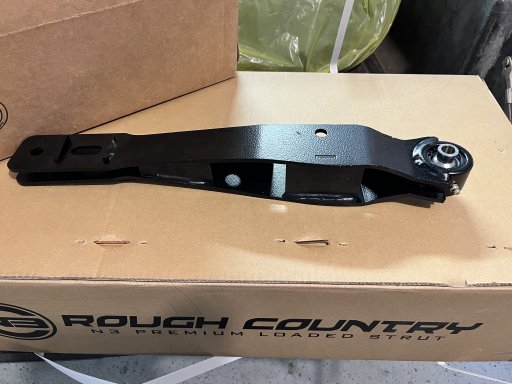

Here we go. Almost realtime updates on the pat upgrades. Here are the photos of the new goodies going in today. The pat waiting impatiently to get its broken legs in the rear fixed.

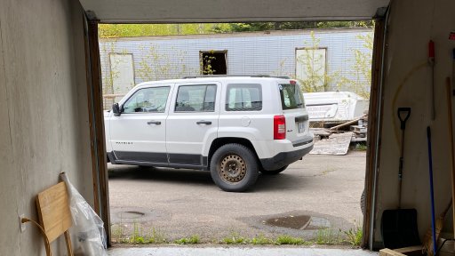

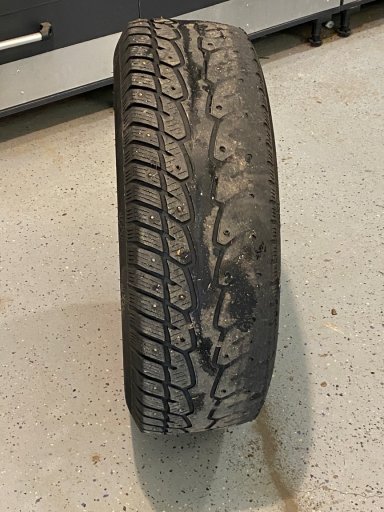

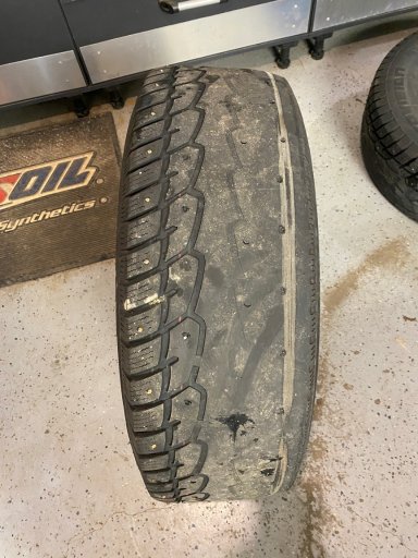

After getting rear arms installed. the rear tires are still tipped in at the top, and the front ones are not installed as the bolt holding the ball joint in is seized solid. I don't have the heat required to losen it. Off to the garage on monday to get them installed and a full wheel alignment/overhaul done. I am not happy.
All I have to say is WOW. Our jeep drives like a brand new rig. it has 130k on the clock right now. Pics to come. The back wheels are now sitting properly to not wear the tires on the insides. AND, another bonus, the rear sits higher now because all the suspension is at the correct settings. The Pat drives smoothly and rolling resistance has been reduces since there is way less friction on the rear tires too. Just a MASSIVE transformation. Pics to come tomorrow.

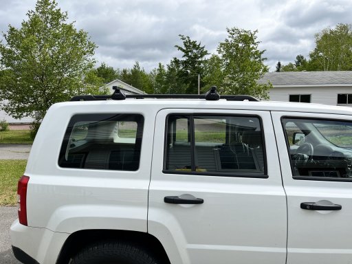

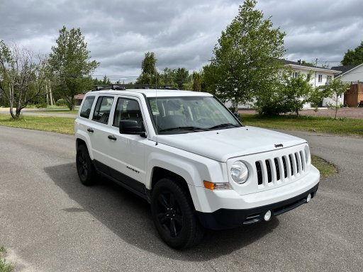

New parts day! Just finished installing our SportRack Roof rack bars. They were listed as Universal, and not able to fit the Pat, but I took a chance and they work great. I love the look of them. I have to modify our kayak racks to fit the bars as they are too big on the clamp to secure tightly. Here are a few pics. We are ordering the platform very soon as well.
