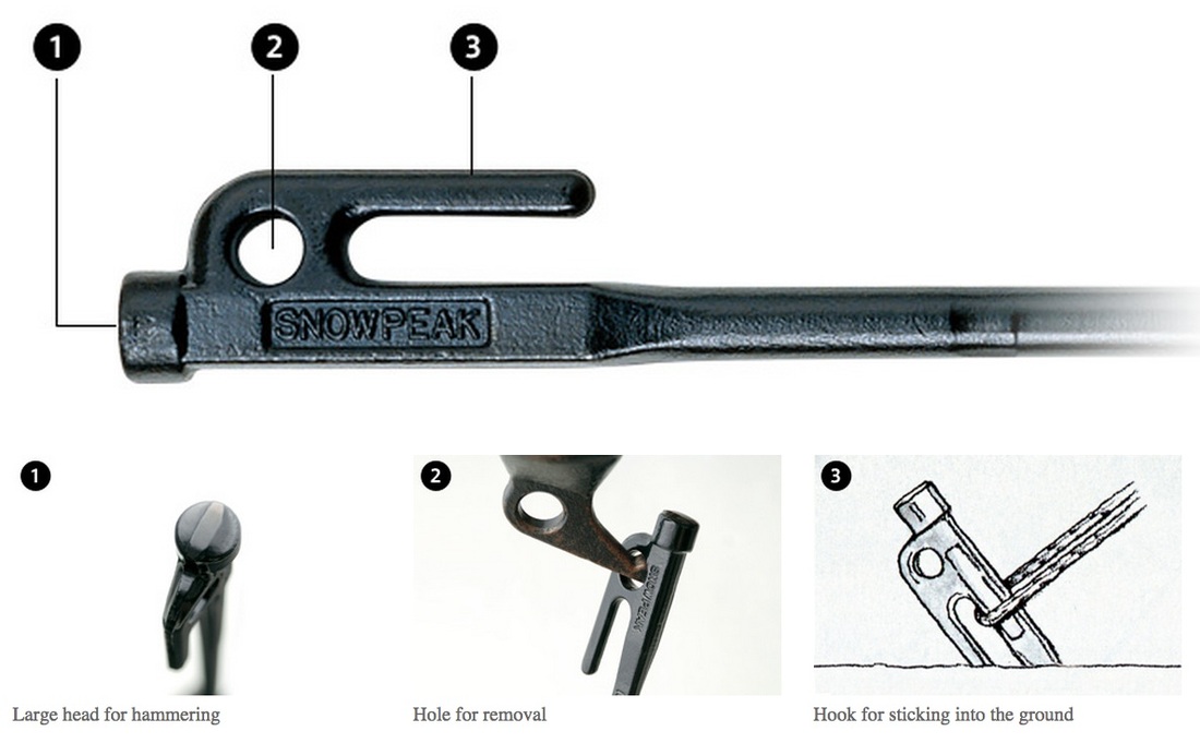

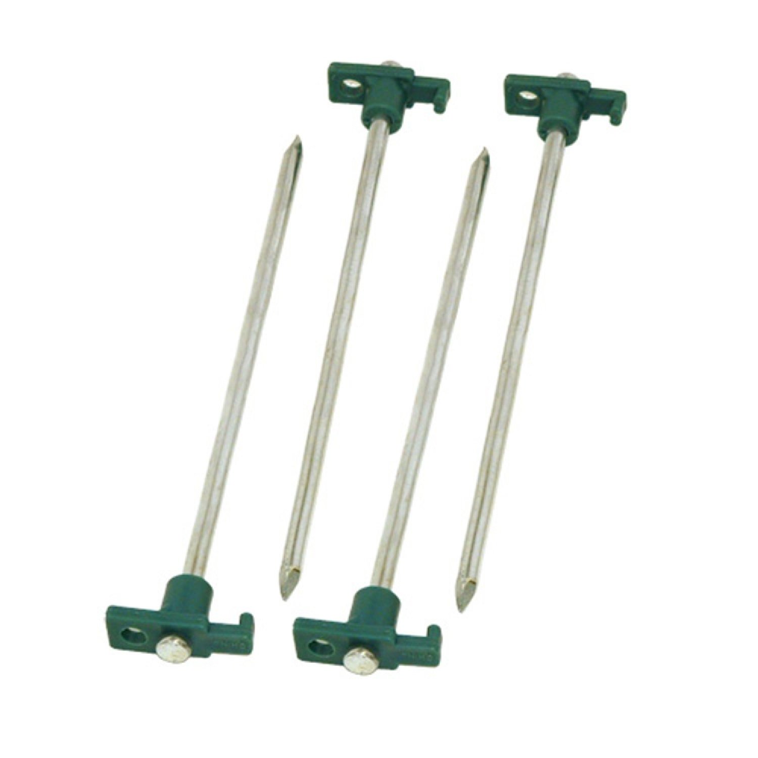

Steel Stakes - These are probably the most common "upgrade" you can get. They are usually a few inches longer than what comes with your tent and are larger in diameter. They still have the hooked end and can take a beating much better. Between the increased length and diameter, you're already a step ahead.
Removal is always a chore, but I've found that using a sturdy screwdriver and the grip end of a breaker bar works well. Slip the working end of the screwdriver under the stake's hook. The grip of my breaker bar has a groove that cradles the screwdriver and helps it not slip. Lift up on the other end of the breaker bar and the stake will slowly, but easily come up. Slide the handle of the screwdriver towards the stake and lift again. You'll increase the angle each time and lift more. Eventually the stake will be out enough where you can use the screwdriver as T-handle and pull the stake all the way out.
