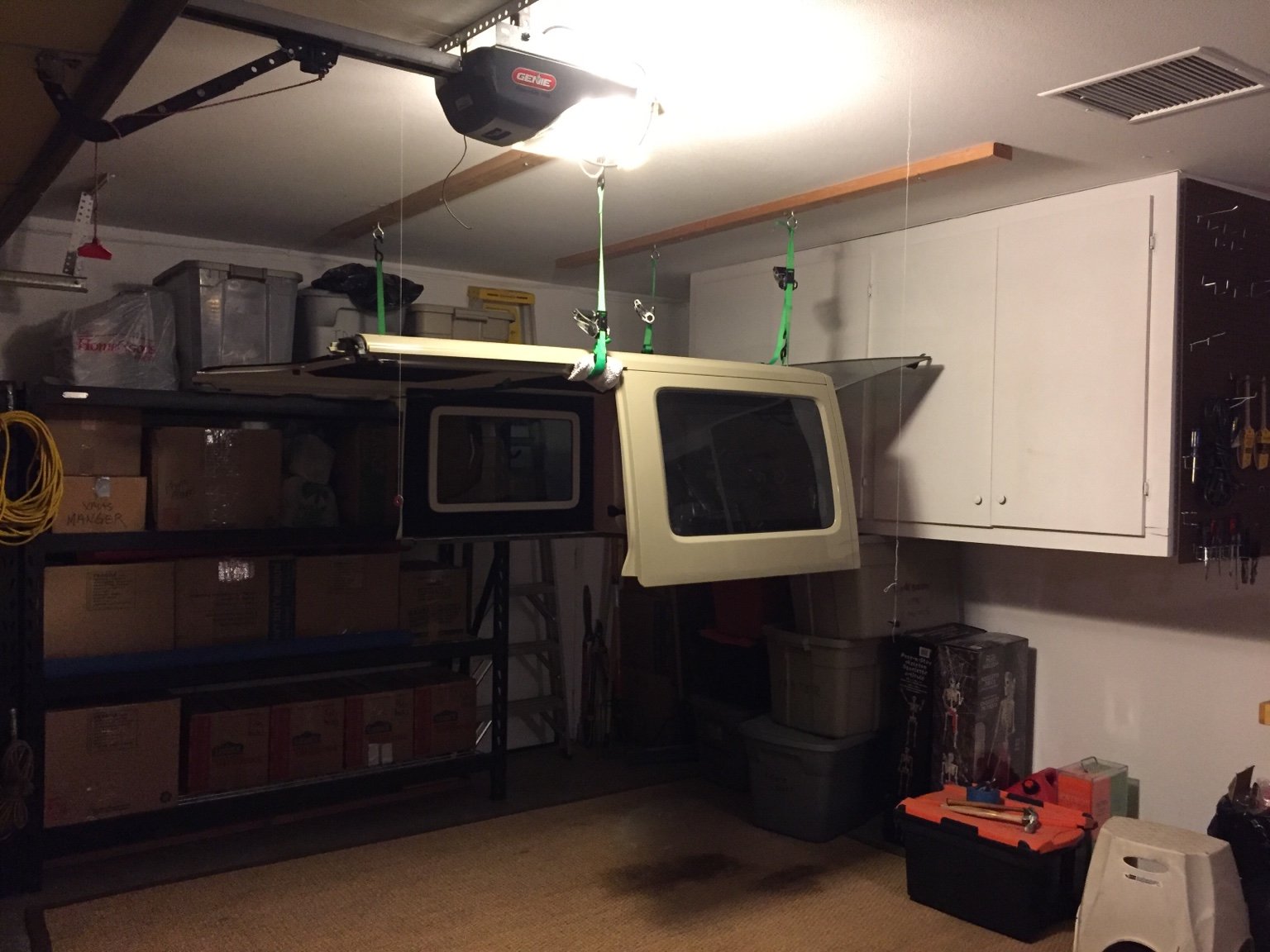

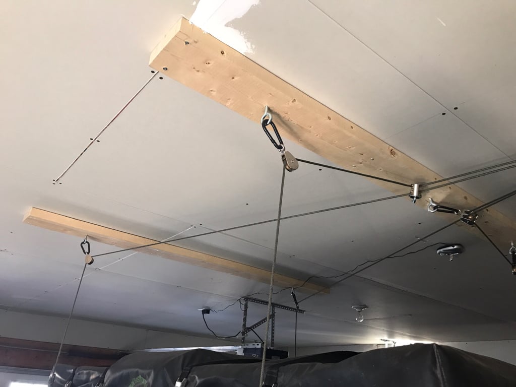

QUESTION and need suggestions.....
There is a really quick way to make my own hoist using ratchet straps and big eyelet hooks.....I just gotta get them screwed into the bottom of the wood beams in the ceiling....
Here is my ceiling:
So my question is.....YIKES!!!! Those are awfully SKINNY boards and if Im down below, even using a stud finder....my margin of error is SLIM!!!
Any suggestions on HOW TO HIT THOSE DEAD ON????
I will be screwing the big eyelet hooks into the ceiling from down below.....

You can mark it with the stud finder then drill a pilot hole. Makes screwing in the hooks easier.

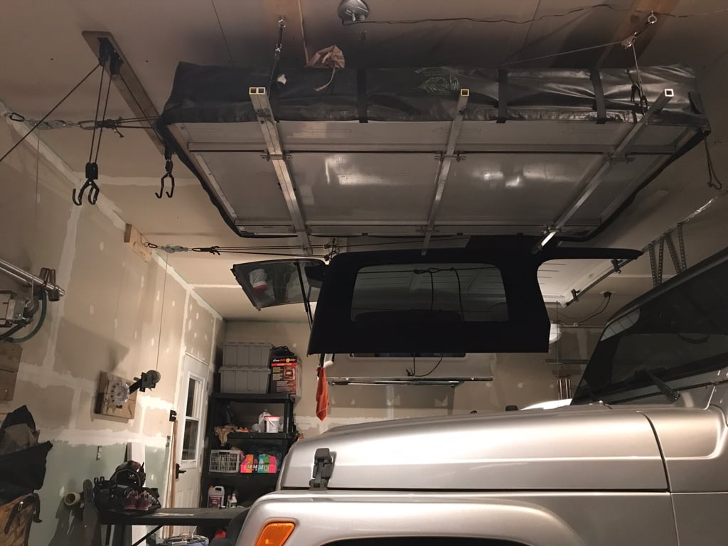

With mine, the studs didn't line up with where I wanted to put the eyelets. So I took a 2x6 and put it across the studs. Screw the 2x6 to the studs then the eyelet into the 2x6.

An old trick is to locate the beam with the finder, then tap in finishing nails to locate the sides. I would also say that you will be suspending weight from those beams, and if you're not comfortable, you may want to hold off and grab a professional or someone who has a little experience with this kind of stuff.

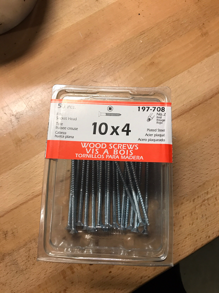

dblack- am I seeing about 8 screws per 2x6? That is enough to hold the weight of the hard top? Looks like you have something different on yours...about how much weight is yours holding?

Yes. That's 8 - 4" screws through the 2x6 and into the rafter. That's plenty to hold a hard top that only weighs a couple hundred pounds.
The one in this photo is holding my roof top tent. I used that photo because it was handy. The hard top lift is identical (I'm just too lazy to take it down for a photo op). My roof top tent is about the same weight as the hard top.
Brasky- I like that finishing nail idea...little more work, but Id be more sure of myself since Im very 'visual'- would like to 'see' the board outline of finishing nails (no, I won't use the whole box).... LOL

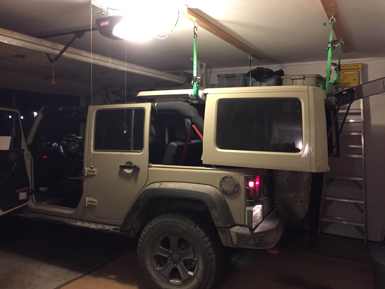

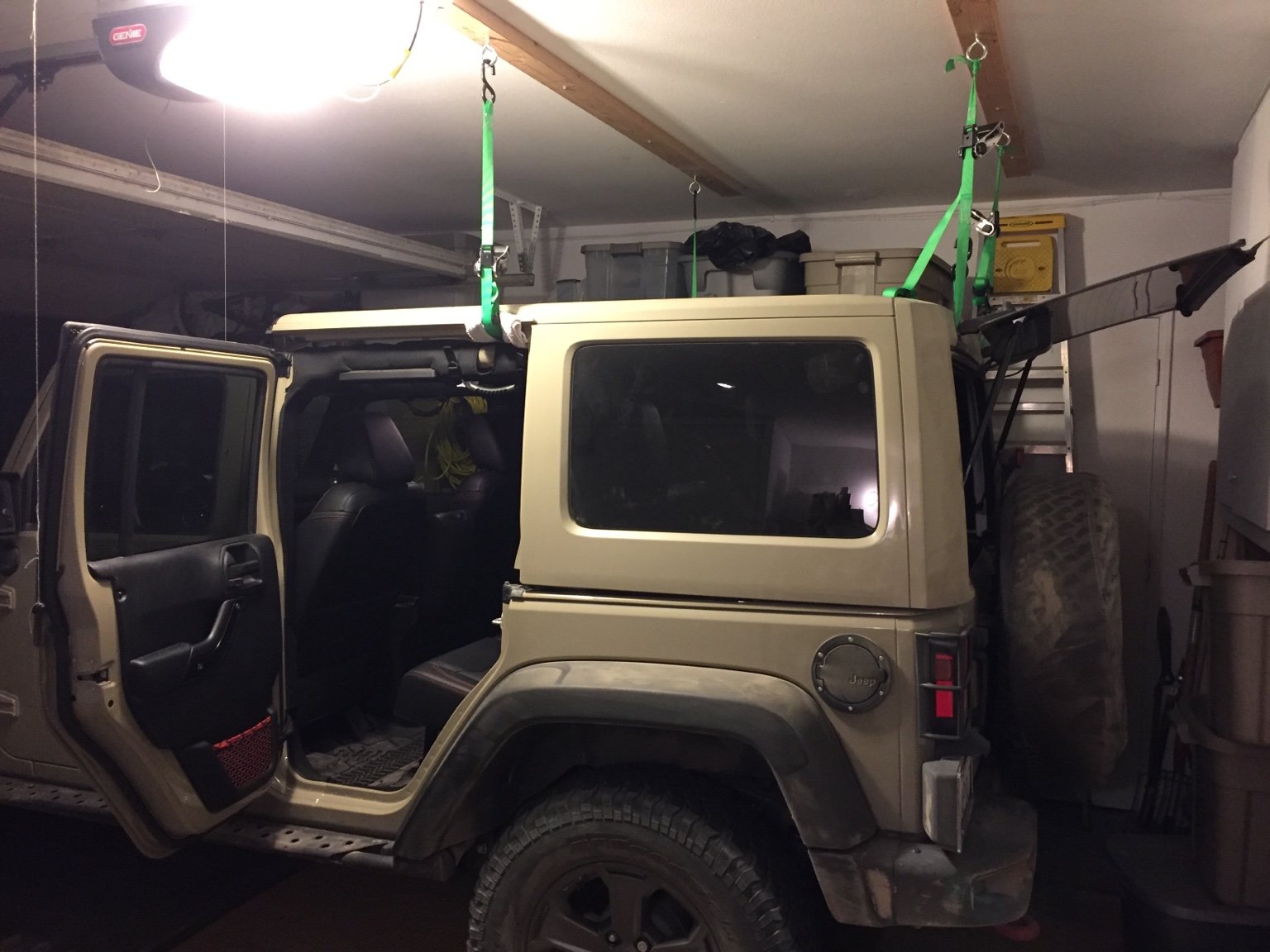

Well- after 2 gals decided “”We can do this!” and tried...... we failed. After about 4 big holes in the ceiling trying to locate where we swore the stud finder said they were.... we hit nothing.... air.
So- I called in the reinforcement, which luckily for me, my dad was in town. Took us the rest of Sat and Sun to complete.... but we did it!!!!
And then another OB’er (Sgt.) came to the rescue and showed me how to take my doors off..... so I’m the Full Monty right now and loving it!!!

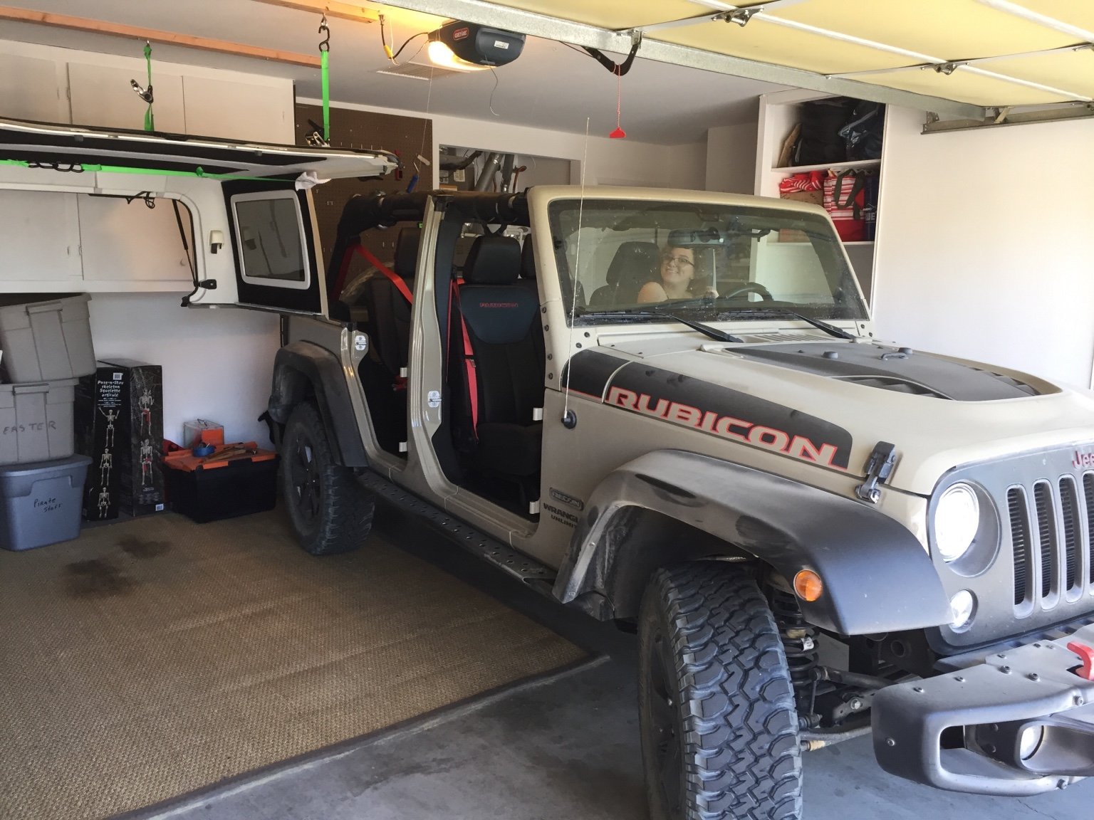

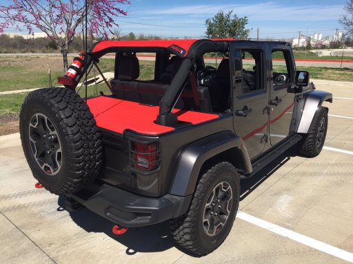

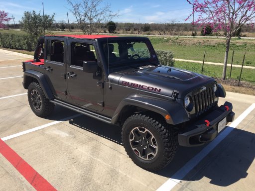

Cheap & Simple Solution: Don't have pictures right now, but I merely screwed four hooks into my garage ceiling joists; ran a 1" ratchet strap front to back on each side inside the top (make sure you don't run the straps under the roll cage) and ratchet enough to clear the cage. I usually lift the top about 6" off the vehicle and drive out. Of course, you have to back into the garage for this to work. During periods of "top off", I pull into the garage front first and my hood slides nicely under the suspended top. I have a 2017 JKURHR and I've gone weeks at a time with my top off. BTW, I found this simple idea on YouTube by a woman who showed that even she (at 5'4" and a slim frame) could handle this method. It does work great!
By the way, you'll need a good sun shade and tonneau to cover your rear cargo area. Here are mine. The sun shade cuts out about 80% of the UV; still very much open to the sky. The mesh is just the right size. JeepTopsUSA is a little pricier than the competition, but here in central Texas we need a good quality shade to last multiple seasons.
