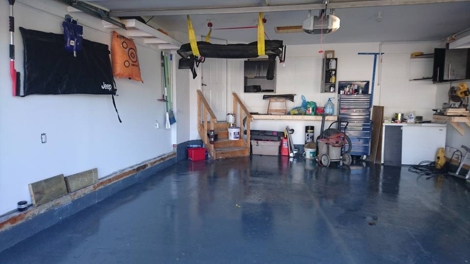

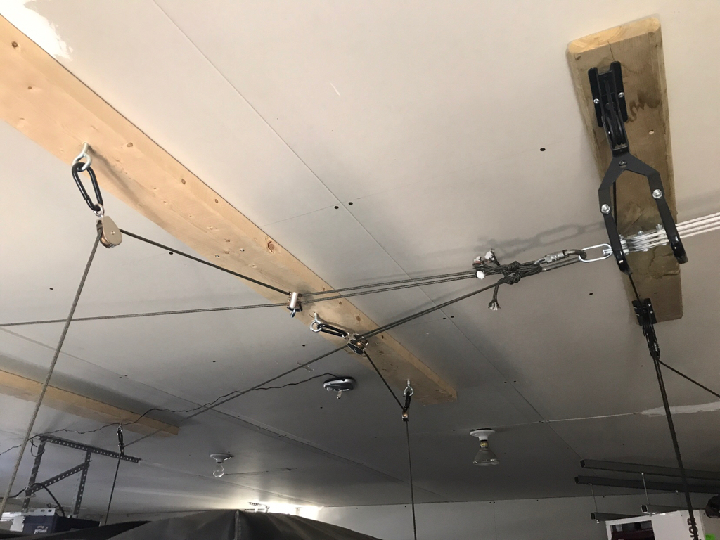

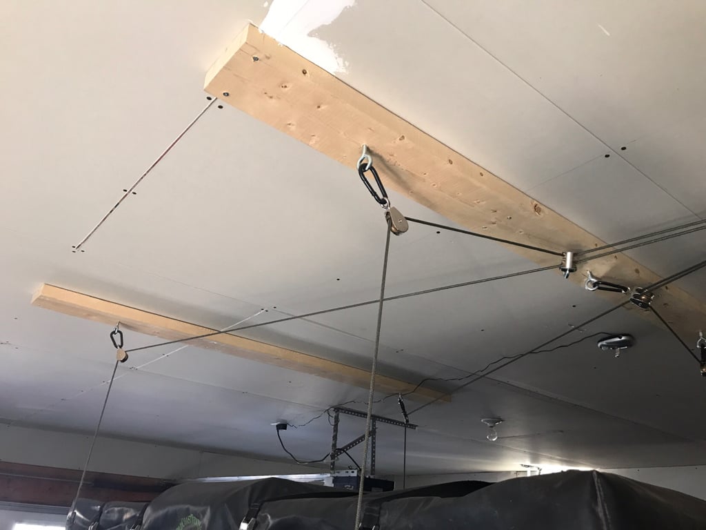

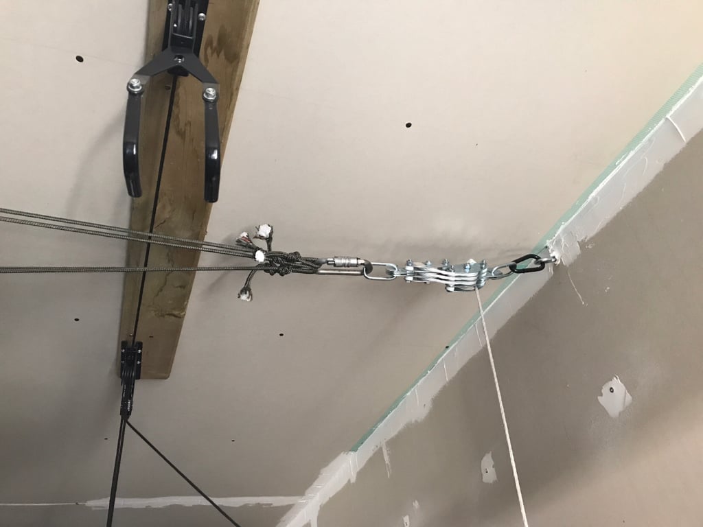

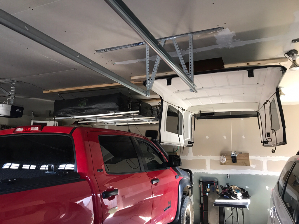

I built a little pulley system for both the roof top tent and the hard cover so I can remove on my own. Pretty simple and only cost me $150 in hardware at princess auto.
I'm running out of real estate. Lol
2 separate but identical systems side by side by the way.

Huuummmmm dblack....I love the pics but that looks complicated! LOL Im sure between your pics, asking you some questions and Youtube- I can figure it out! Thanks!

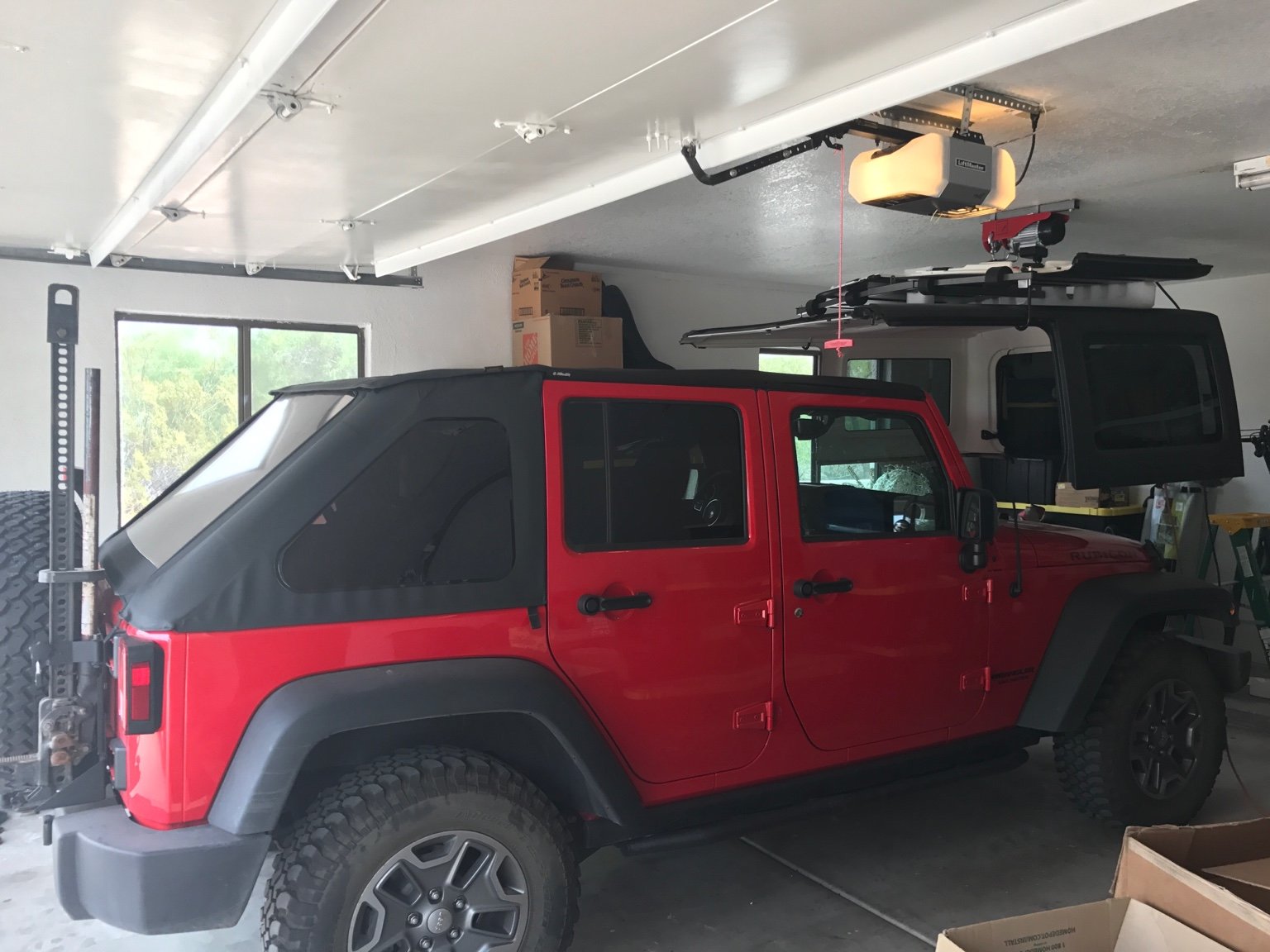

I have a JKU and the top is a lot to handle on your own. It weighs about 120 lbs and is really awkward to handle. Getting it back on is even more difficult and almost impossible to do without a scratch here or there. The Harken hoist is a good manual system for under $150. I initially bought that but than opted for the electric winch style, which is a much easier setup, but pricey at $400 (in the pic). Also worth noting, having a friend help is free ;)
Hope this helps!
Reactions: Roxxie

DANG!!!!! Checked out that system and LOVED the electric push button....is it really that much?! Now I'm crying.... LOL
Nice set up and Jeep!

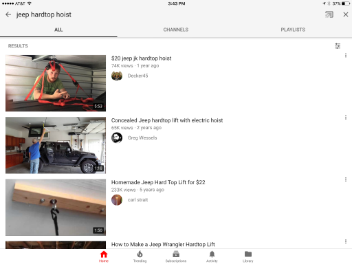

Checked it out and you and Jeepney have the perfect solution. Those Harken Hoists look fab. Just wish I could do the electric one! LOL
Did you see the YOUTUBE video of the guy who made his come out of the ceiling? Like the whole thing was hidden!!!! SWEEEEET!

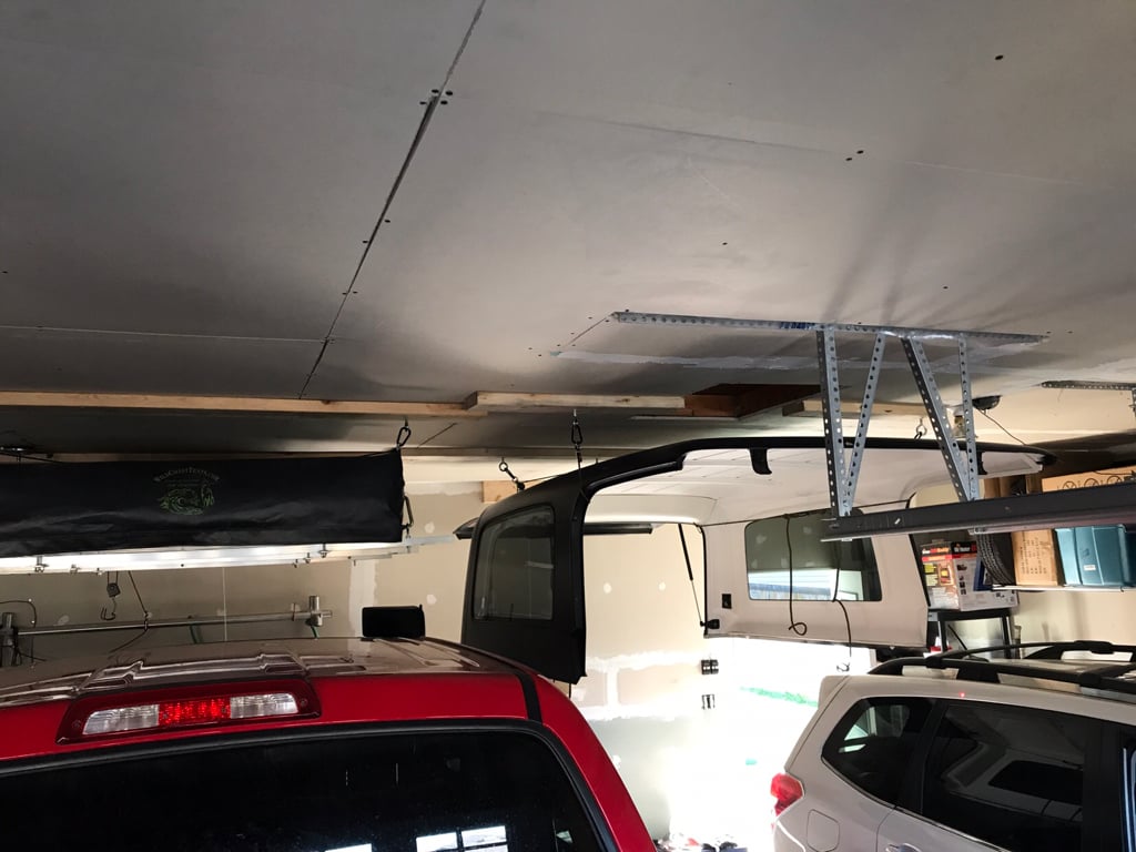

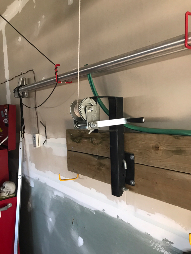

I built the concealed hardtop hoist in my garage, I don't have much space when two cars have to be parked in it. The link in his you tube has full instructions, but I went with this concept in my garage. http://panofish.net/garage-trailer-lift/ took a while to build and it's not complete done because we are in the midst of finishing the garage. It's holding the spftop for now, and I'll park my other vehicle under it for the winter.
